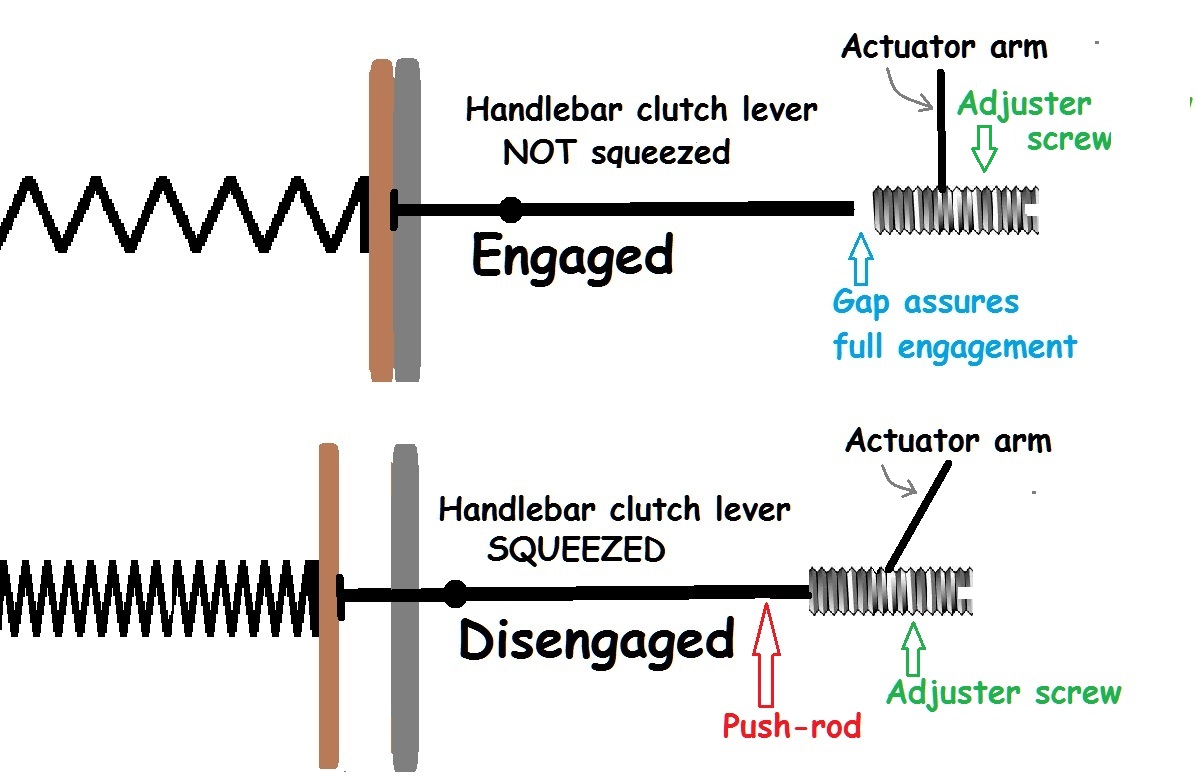

Here's a more legible version of the procedure for clutch push-rod adjustment --
Clutch push rod adjustment is a routine maintenance item explained in the service manual.
Assure having some "slop" in the clutch cable, using adjustments at the handlebar lever perch and at mid-cable along left frame down tube near the exhaust header.
Removing the access plate should reveal the adjustment screw and locknut.
First, slightly loosen the locknut.
The hidden end of the screw interfaces with the push rod.
The basic idea is to lightly seat the screw against the push rod, then back the screw 1/4 turn away from the push rod, to thereby provide a small gap between end of screw and push rod.
Here's a possible snag ---
The screw is part of an actuator assembly.
On some designs (screw-type), the screw turns clockwise to seat before turning counter-clockwise to provide the gap.
On other designs (ball and ramp), the screw turns counter-clockwise to seat before turning clockwise to provide the gap.
If the attempted adjustment fails when turning the screw clockwise to seat before turning counter-clockwise to provide the gap, try again by turning the screw counter-clockwise to seat before turning clockwise to provide the gap.
Remember to snug the locknut before finishing. Just snug is plenty tight enough.
Lastly, reduce "slop" in the cable to produce desired amount of free play in the lever at the perch.

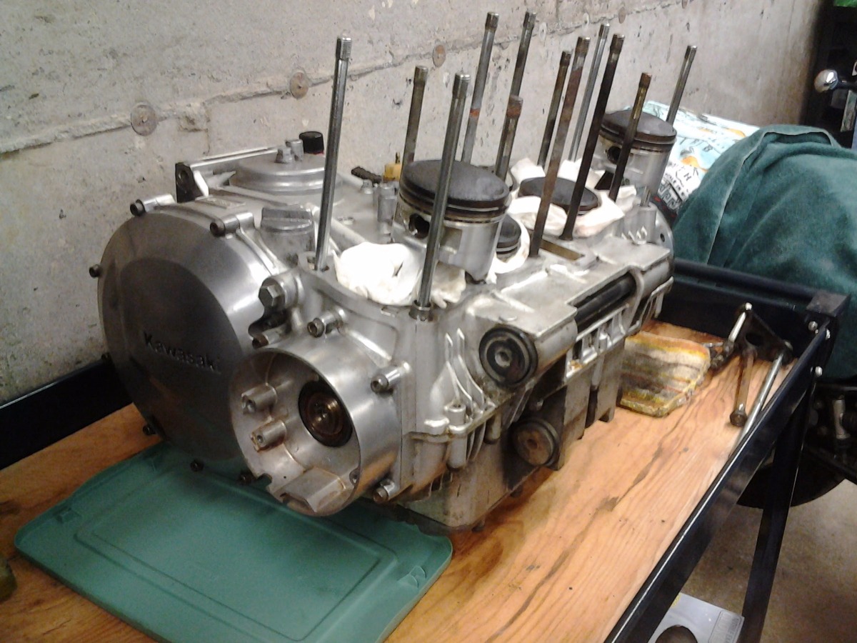

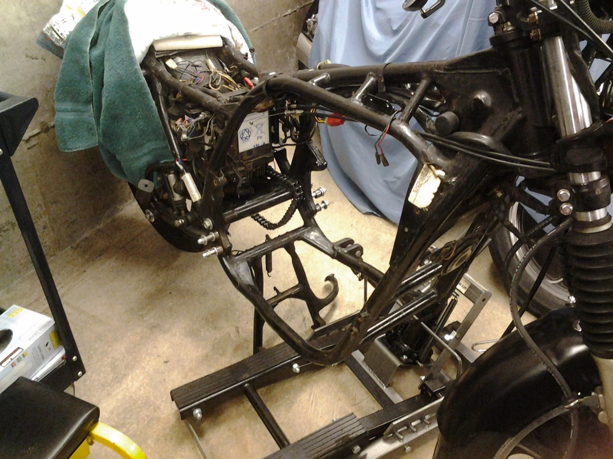

So, fast forward to now, I decided to take the bike apart. It was smoking on start-up and knocking a bit so I tore it down to parade rest. Engine out and down to frame. Powder coated the frame, swing arm and battery box. Changed out to chrome front fender. Rebuilt the engine. New rings, hone ecg. New seals in the head and lapped the valves. Engine is back in and tank is drying. Working on the wiring now. Still need a seat. I think I'm going to go with custom build on it. Some pics for you.
1990 KZ1000P, 72k miles, 10 years in storage, new, bars, tires, chain and sprockets, seat, carbs cleaned, police equipement removed.
