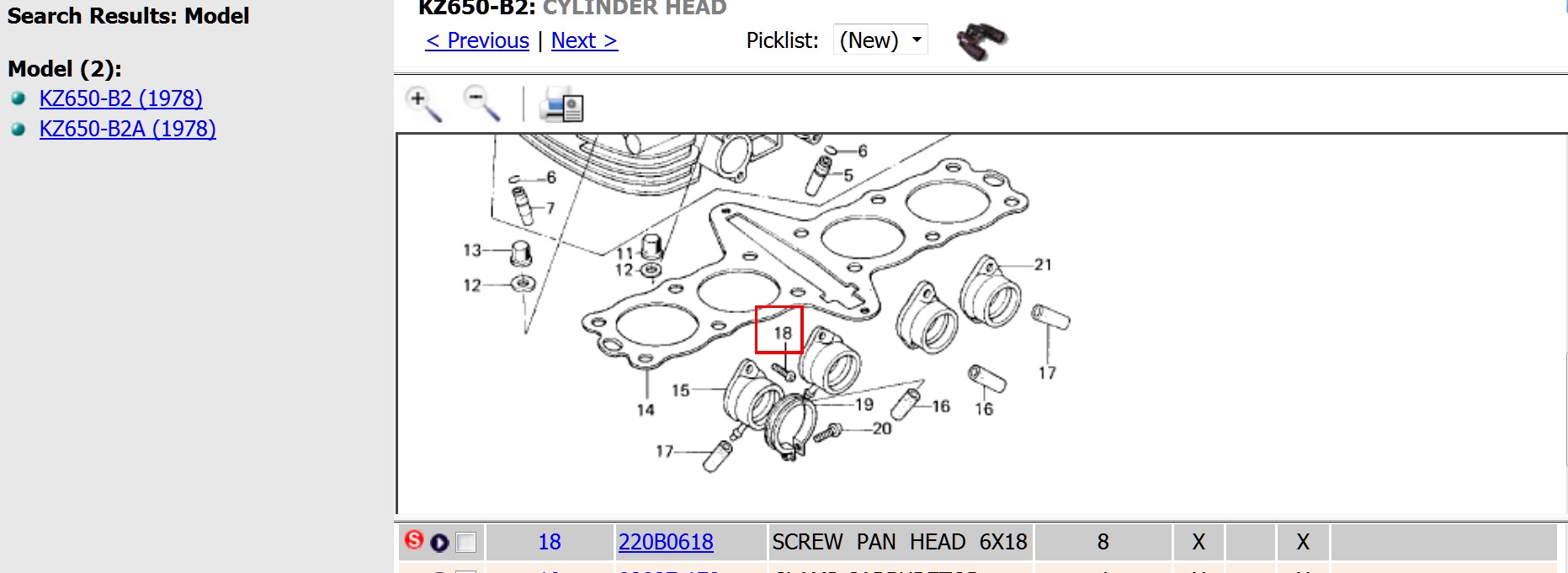

I seem to have misplaced my carb holder bolts. Planned on replacing them anyway, but now I don't have an original to take to ace hardware....anybody know the specs offhand? Kinda wishing I had catalogged/documented the tear down just a LITTLE better! Thanx all!

My parts diagram shows 6mm x 14mm. Ed

Kawasaki.com says SCREW PAN HEAD 6X18
Part # 220B0618

14 Mar 2014 16:15Patton wrote: Kawasaki.com says SCREW PAN HEAD 6X18
Part # 220B0618
For comparison with hardware store pricing:
www.partzilla.com/parts/detail/kawasaki/KP-220B0618.html
Interesting! I have 3 different Kawasaki Parts Catalogs for the KZ650 and they all show 6mm x 14mm. I'll post pics when I get a chance. Ed

The 3 different Kawasaki Parts Catalogs I have cover the 1977-78 KZ650 B & C models. They all call for part number 220B0614 which is 6mm x 14mm. I don't know when the change was made on Kawasaki.com or if the 6x18 will fit without bottoming out in the cylinder head. Ed

Thanx again guys! I did find my original screws for thread reference...the holes are very deep...the bottom ones actually pop through to the open...short answer...you are both right! Got stainlees allen heads for about a buck each!
