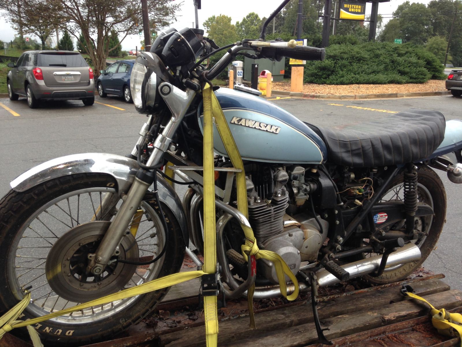

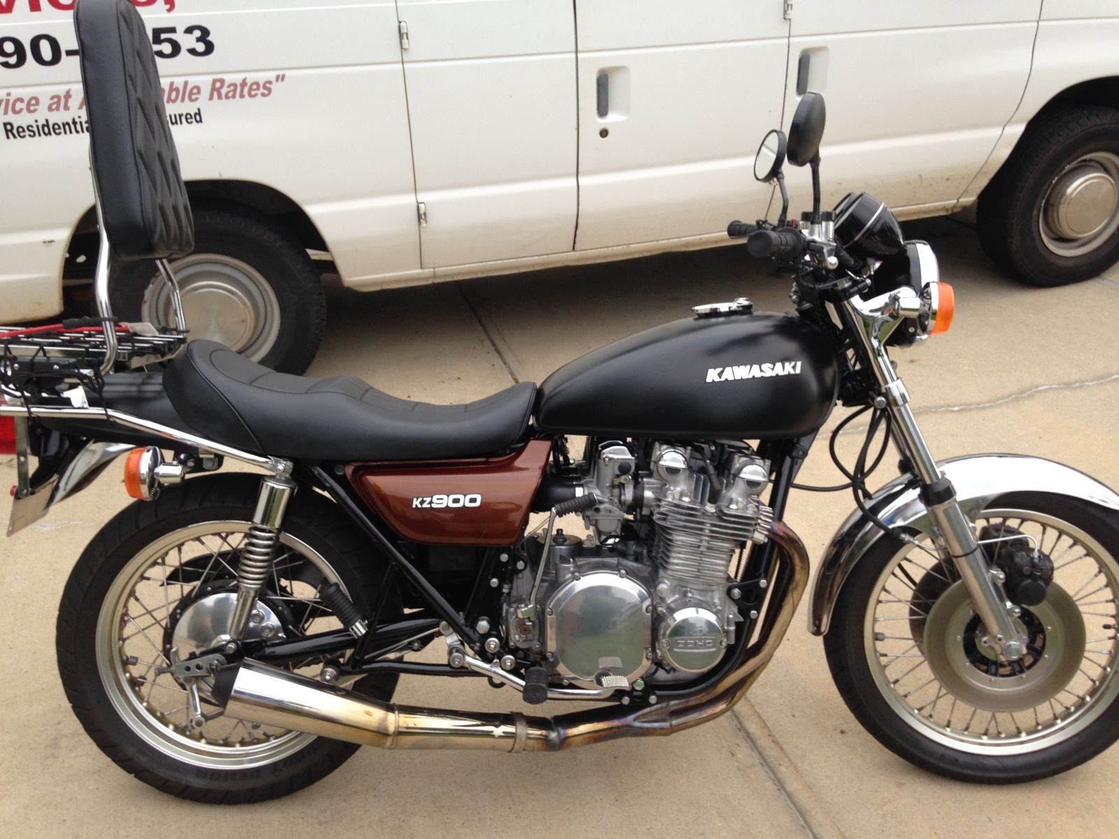

I think I saw you post the bike on the trailer on the Facebook page.
Im not even close to being done with the first one, and I already want another one! To be honest, part of that is because I would love to just have one to ride around rather than the 81 CB750K Im on for right now.
Great job on your first restore!!
