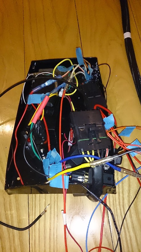

After hours and hours of wiring, measuring, beeping through wires, terminating connectors.... my wiring harness is 95% completed. Doesn't look all that pretty yet, need to put it on the bike and make sure that it's 100% before i tidy and wrap things up:
I've fit all the elctronics into my custom tray. Needs some tidying up in there, I will fasten the components which are not bolted down with some industrial velcro. I have in there my RF ID ignition circuit, my failover key ignition (in case the RF ID fails
), LED relay, engine kill relay (the switch on my controls are N.O. so I need a relay), stock rectifier/regulator underneath the tray for cooling and the stock fuse box:

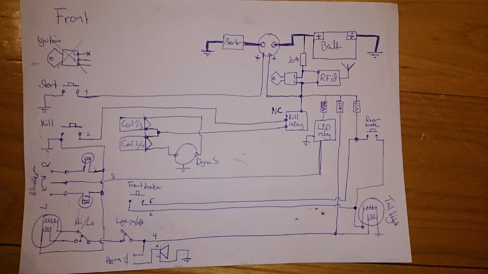

For the wiring I've made this basic diagram that I've followed. It might miss a couple of things, but these are my basic thoughts on the wiring:
I hope I've got it all sorted out. My initial on the bench tests seem to work. I will try putting it onto the bike in the next few days and test the basics, lights, blinkers, starter signals etc.

looks like you are almost there on the wiring!

MAN that has to have taken AGES!!! Good Lord!! That looks great! I applaud your patience.

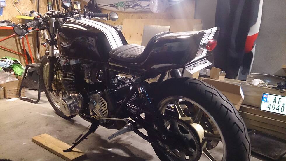

Finally an update to this thread
I have been working long nights for the past week after getting my top back from the shop. The install of Gpz1100 cams went smooth and everything after that. I got the bike finished today and manned myself up to push the start switch. It actually fired. Woohooo!!! I have some adjustments to do on the carbs and the dyna ignition timing, will look at that tomorrow.
Good night!

Sounds like you're pretty much done Tommy! Great news! A lot of projects here never get finished for one reason or another. I see a lot of unfinished projects on craigslist as well of all different makes. Glad to see yours was not one of them. Be sure you post lots of pictures once you have her 100%.

Bike looks great!

Wow awesome bike I like what u did with it. I'm glad u kept on going even though u got all that hate.
