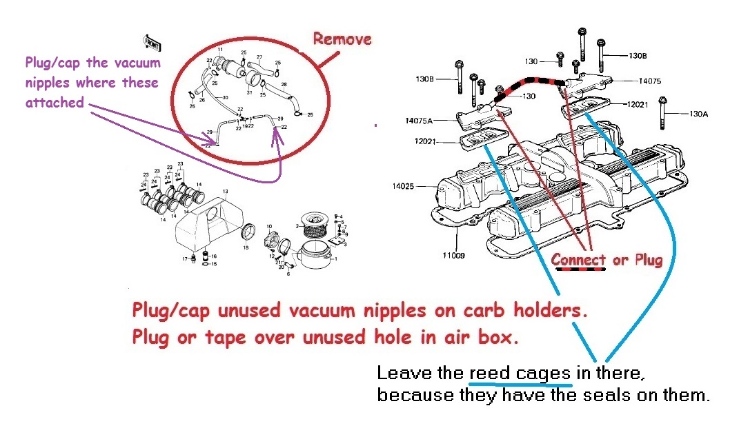

lightitup wrote: thanks guys i will try and order them next week funds are on the low side
can the black hose that goes from the airbox to top of the engine be removed and caped off even if im still using an airbox? i know i would also have to plug the ports by the carbs.
Good Fortune! :)
