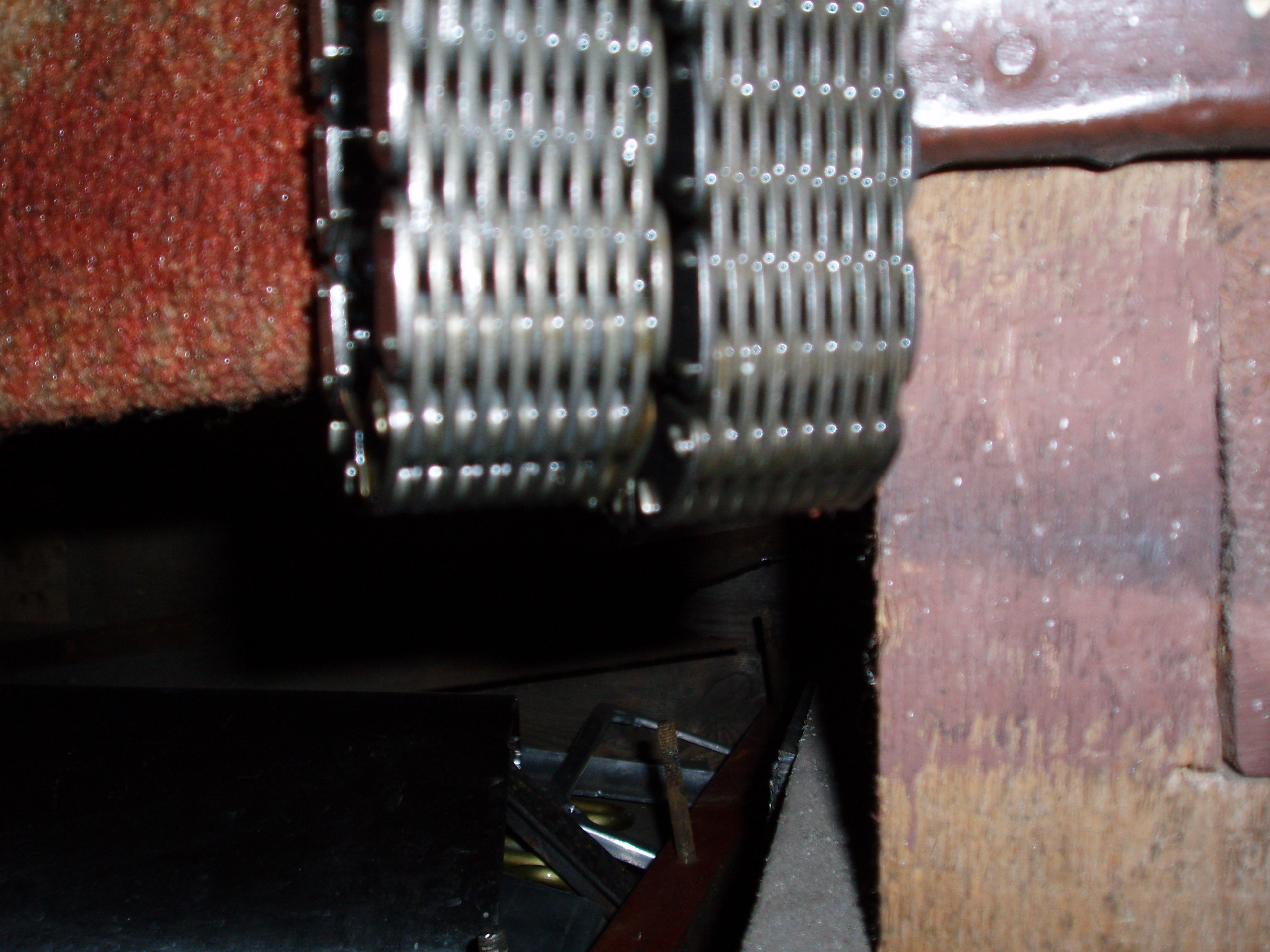

I was wondering, why the engine made some weird noises: like 100 of loose bolts &nuts were inside
That's why:
Will change the primary chain to shorter one:
Got some moisture in crankcase:
& the oil cooler will be installed....

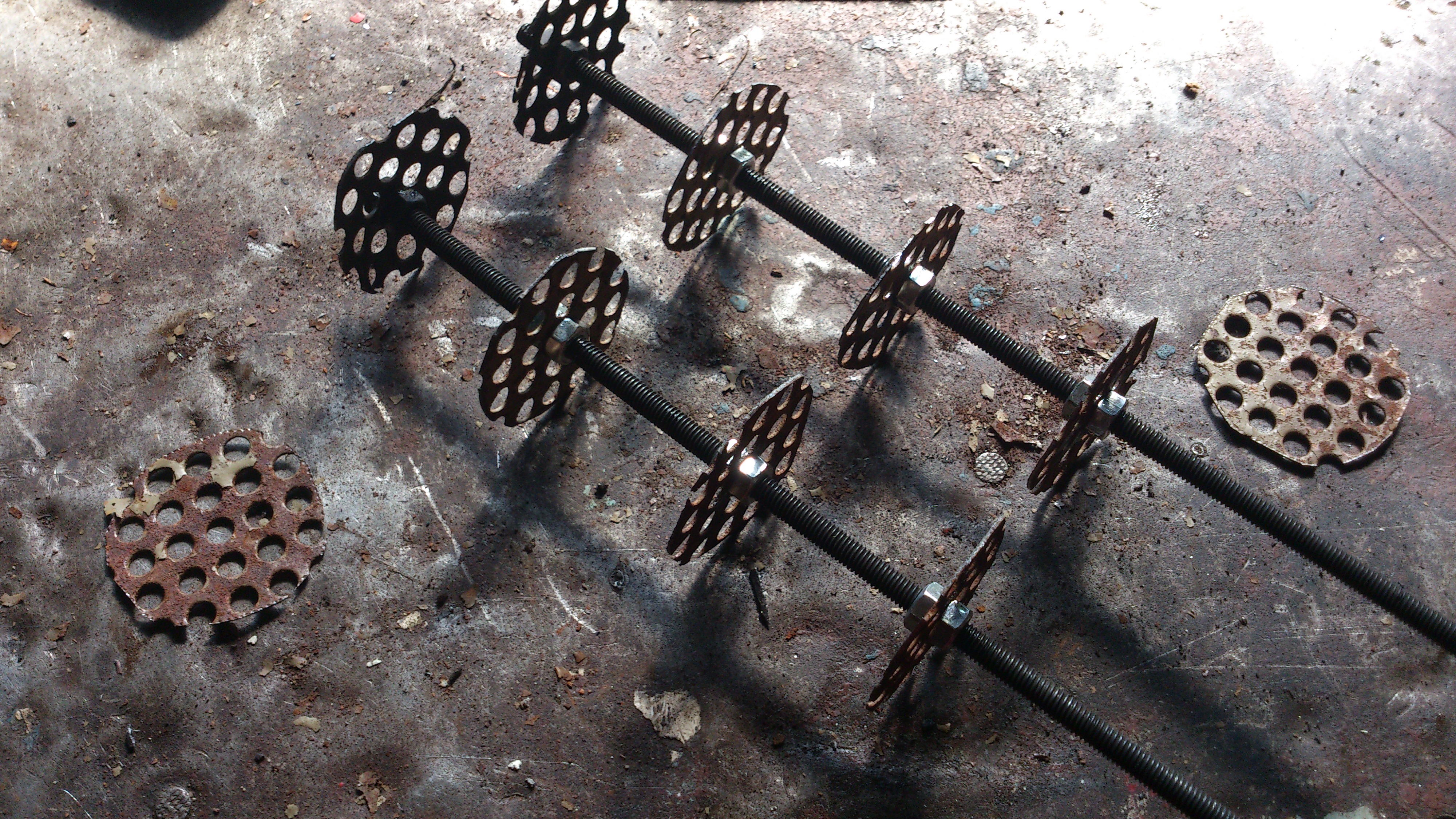

Replaced the Chinese pod filters with Ramair socks :
Used old pods for "base"
In my climate and driving conditions, the "budget" pods mean that the cyl. and piston section will wear down in one season!
So got the connections covered, new signal lights etc in place and it looks like this:
