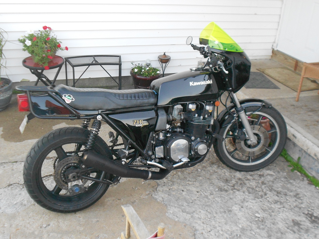

Ok Leon, you win. But I cry foul for the shameless display of one of the most georgous bikes ever :laugh:
My only issue with your method is it places the threads in bearing, albeit inside a spacer and not directly in the shock mount. You would need to make a round jig with a bushing to keep the drill and tap straight and centered.

alan,
you are correct sir.
mine are spaced out with some aluminum spacers i machined out and some thin steel sleeves over the threads that came with my progressive shocks.
they have been fine for a few thousand miles so far,and works well enough i haven't done anything better :whistle: .

oh yeah,
i went one step further and slotted the bottom of my aluminum spacers so i could remove them without removing my shocks.
soooo :whistle: ,
i could use the space for the front mount of my custom luggage rack i built.
it attachs to the shock studs by some slotted spacers welded to the front of the rack and machined out spacers that fit the turnsignal mount holes and countersunk allen heads through the backside.

Those are 2 different bikes Leon. Now you're just showing off. X 3, come on man. :)

in my defense sir the mk11 is just for the pic of the upper shock bolt :whistle: .it is a sanctuary built bike.
the z1r pics are the same bikes but the pic from the back is right after i rebuilt it from a wreck and the pic with the rack is after i had time to redo a couple things :cheer: .windshield,header,seat cover etc.
