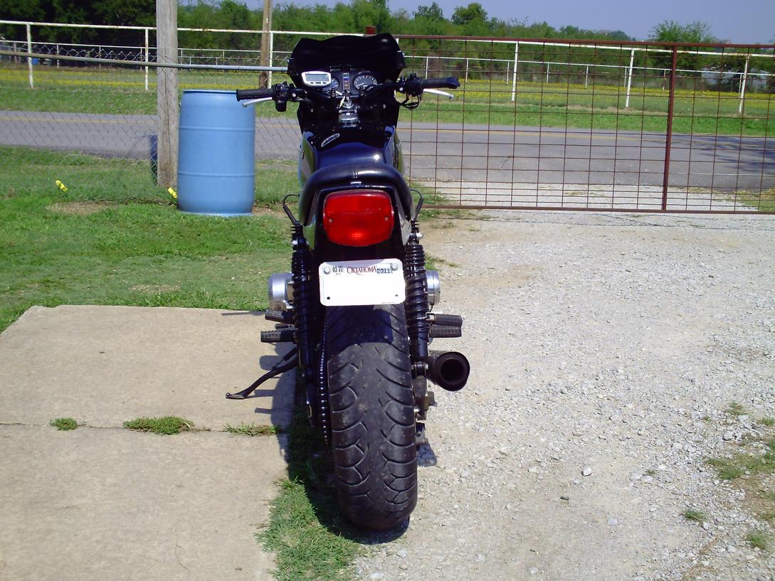

531blackbanshee wrote: what is up with the engine in the bottom pic?
looks like 650 bottom with a 900/100 top end :blink: .
Frame is modified, look no bottom engine support. Also look at those rubber mounts on the the sides..(drool). That or it isn't a kz frame.

It's a 750 ZEPHYR engine AND frame.

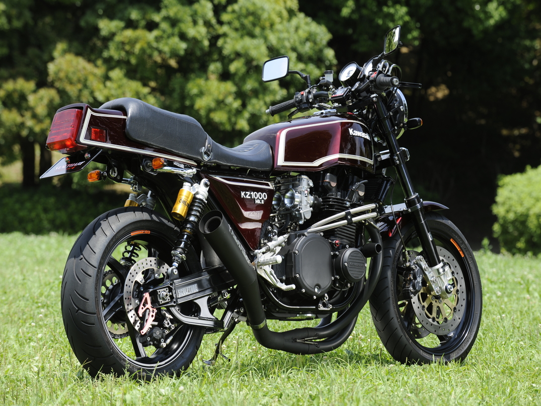

  • 531blackbanshee
  • 531blackbanshee's Avatar
  • Vendor
  • Vendor
  • Posts: 7442
  • Thanks: 796
Re: HollywoodMX's Drouin Supercharged 77 KZ1000!!
26 Mar 2013 11:19
#578867
if i could draw your attention to the upper shock mount on this bike to illustrate what i am talking about with a bolt and countersunk washer.
