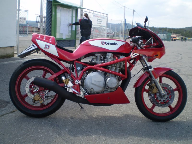

if i was going with the bimota tank and tail,
i would probably keep some period wheels and get the brakes upgraded,build my own swingarm to match the style of the one in your pic but in stock or close length.
i would then get some fork emulators and new springs for the front forks,some of those ikon shocks like tri bought,avon road rider tires and go with a bimota paint scheme in green and white.
except i would want a candy lime green and would use close to this paint scheme.
i would keep the frame black.
or i would slam a zx6/636/10 frontend on it with the six spoke wheels,like these
then custom build my own underbraced round tube swingarm to accept the zx wheels and use all the zx brakes and keep the ikon shocks.
i myself would prolly go the later route.
here is what i mean by my own underbraced swingarm,
thats my .02 ymmv.

531blackbanshee wrote: if i was going with the bimota tank and tail,
thats my .02 ymmv.
Thanks for the advise. I was actually bidding on the OZ wheels that match the gold rims in my earlier bimota post but I stopped at 700.00 and it kept going. I couldn't justify 1k for those wheels considering I still need to update the brakes. I talked to the seller and he said the Japanese were all over them and they would have gone past 800.
I appreciate your ideas. I think I like the twin shock swingarm, zx6 front and zx6 spoke option you described. Plus I think I can swap my KZ forks, front and rear wheels onto my TR-1 which I wanted wire wheels for so it can be win win.
les holt wrote: That thing is freaking cool! That's some pretty slick work on that heads fin work.
I'm finishing up a round tube arm for a guy now, I should be able to post pics maybe by monday of a finished one. 2" over with twin shock set up for ZX6 wheel. I love the 6 spoke zx wheels but they are a bitch to keep clean, went with the 3 spokes and it's much easier, maybe cause they are chrome but don't care!
It looks like my rearsets will fit perfectly for you.
As for late model front ends or usd's, Theres a few options for a somewhat plug and play, Some can be done with just a bearing swap, some require just a stem swap and some just need new trees all together to best serve our needs. There is some trade offs with the newer conversions, mostly with being shorter and loosing ground clearance and second you tend to loose some effective rake on the chassis when the front goes down and the rear doesn't but, you do gain some trail because most have a lot less offset in the trees. I've got 2 chassis going on the jig here in about 3-4 weeks, I do some playing around with different combos to see just what kind of numbers one truly ends up with. The gains are both the added rigidity plus the brake upgrade! Those 2 things are big by themselves let alone the wow factor when it's pulled off right!
Les
Thanks! Ya I will go with your rear sets and I am interested in the easy swap swing arm.
Is there a difference between the zx10 or zx6 6 spoke wheels? Are the differences in the zx6 or zx10 fork swap? What years bikes are we talking?
Thanks for the help so far everyone!
