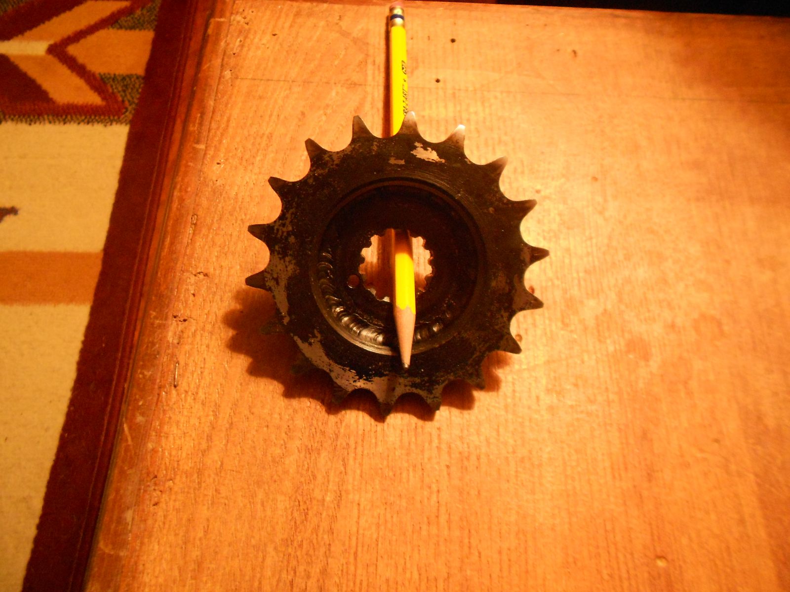

- Posts: 7442
Re: kz1000 rebuild Almost done~
04 Jun 2012 10:51
on your sprocket issue.
break out the string,(or laser) and measure what the offest is between your rear sprocket and your front sprocket.
once you figure that out,gimme a holler and i can take an old kz sprocket and your new one and fab them to have the desired offset.
here is one i have done,for ramtough.
i love the look of your paint(have i said that before :lol: )you nailed the stance,really nice.

Thanks for all the tips on the Sprockets- HOPEFULLY dont have to machine a new one. although my machine guy is free, i just dont wanna wait! im ganna Order a 5/8th offset an Hope for the best.

OK Nvm i cant find a 5/8th offset 530 online just for 630...
ANyone FIND ME this conversion?
have a 05 gsxr rear 180series rear tire
(thought it was 190)
so Harvey1327 your probably DEAD on with that sprocket...
- Sellitto42kz
- Sellitto
- Posts: 90
- Thanks: 2
04 Jun 2012 22:18
sweet did you make yours? where did u get it ill have to order one meow-
