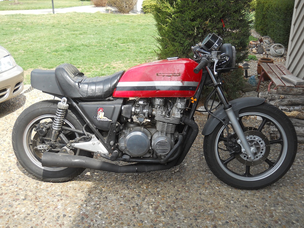

    So after all that this is where I am at, did some more bondo, mounted a new headlight bracket, made a license plate holder, and primed the tank and seat so I can find all my imperfections. It still needs some bondo work but it's closer
Last night I moved her to my brothers garage, and mounted my new brake light, turned out pretty decent I think

    yeah, it has some crazy bend in it, i used steel square tube to build a seat mount to lift it off the bend, and like i said earlier i cut a good 5 or 6 inches off the tail, so i can see why you'd have a huge cowl to try and cover it. What if you tried cutting down the seat pan and making a seat that sits on top of the frame?

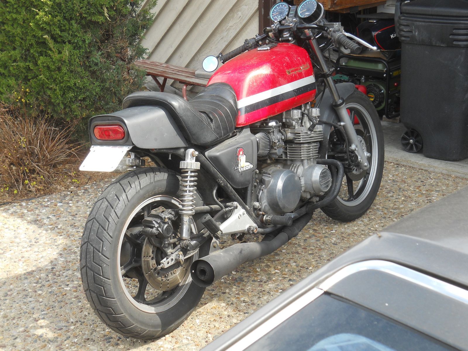

    Welcome ColoPirate, I like the direction you are going with your LTD.
Similar to this

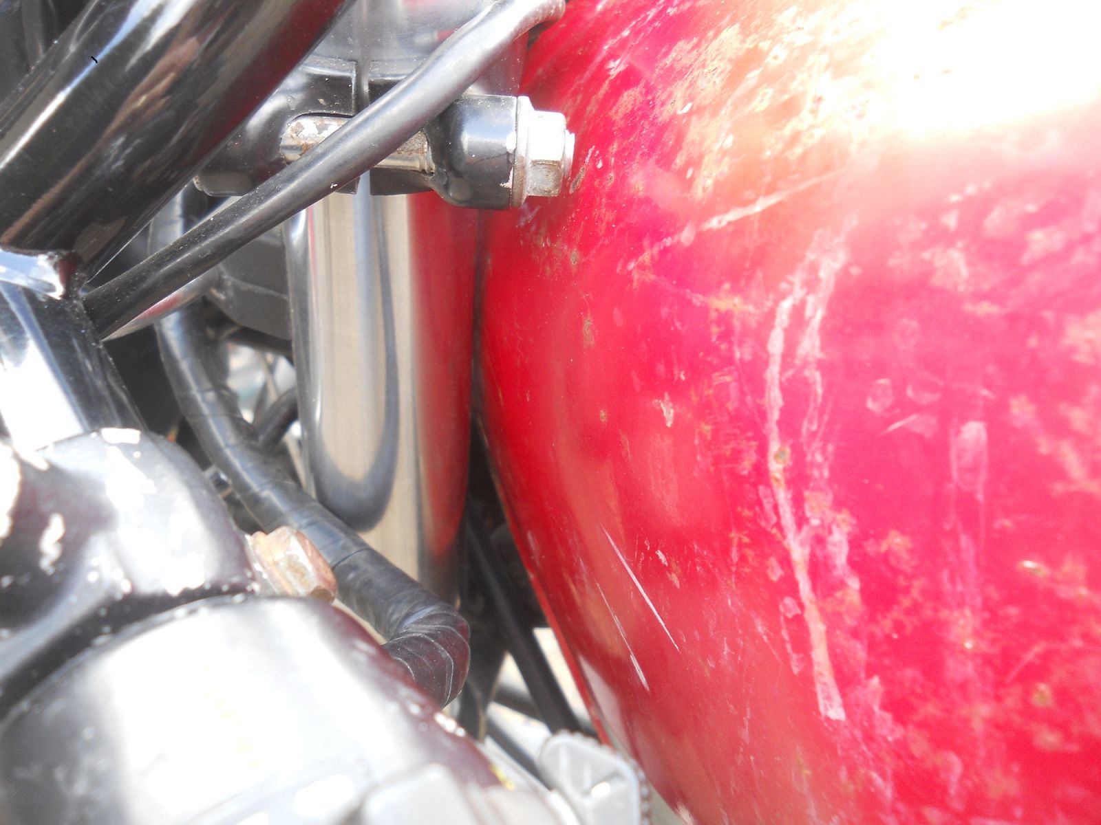

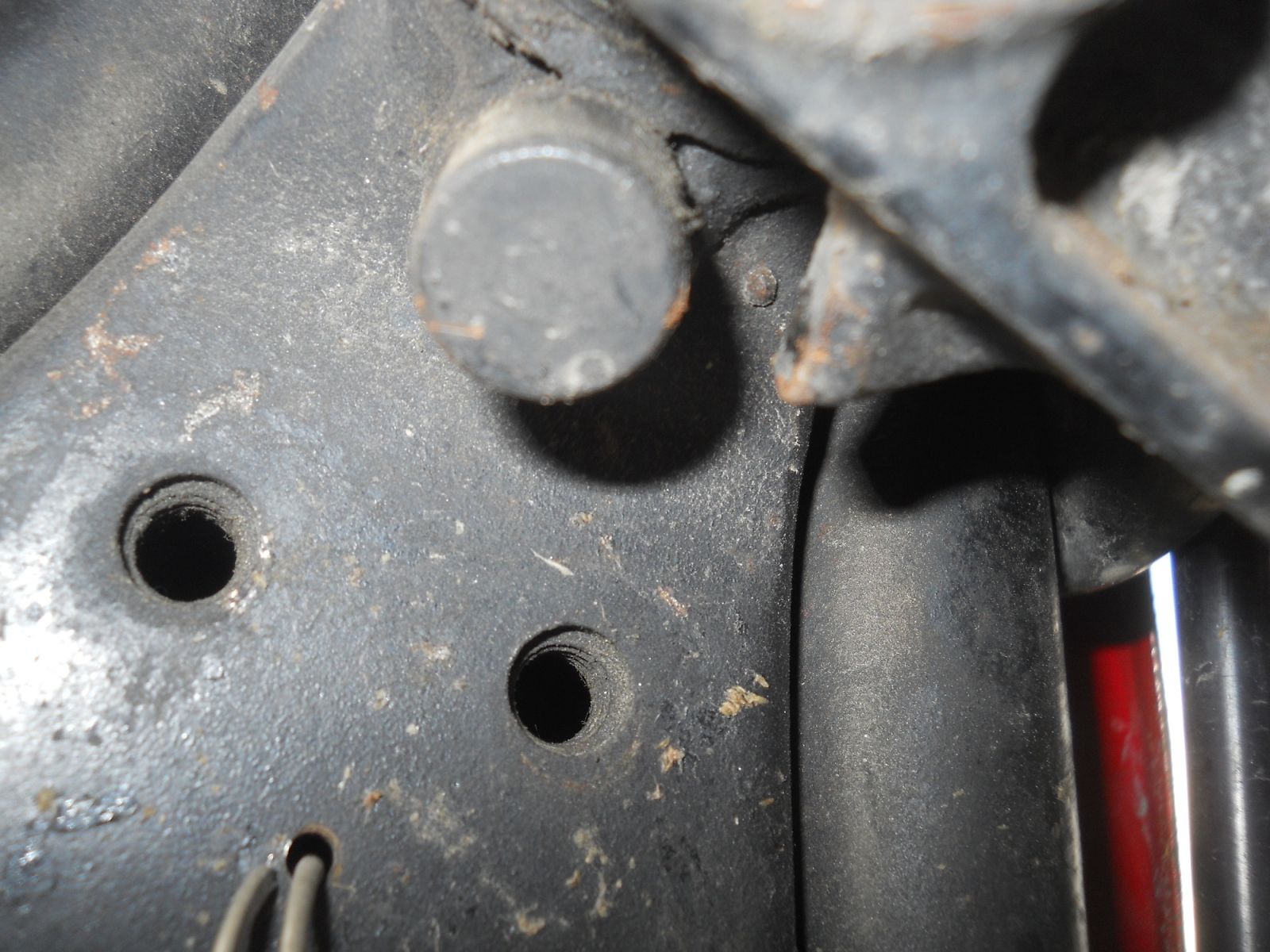

If you have not already checked the stearing lock to lock, this is what you are going to find
Remedy is to block the stops, dent tank for clearance or change tripple tree to non LTD standard with more fork offset. I will be changing the tree.
Also the LTD brake MC works if using clubman bars (tight but workable).

Rainman - very similar! I think with the drag bars my controls are hitting the tank before my triple tree, but when i switch to clip-ons (when i feel like spending another $150) i will have to look for that. what did you use to block it? im having trouble figuring out the picture.

    ColoPirate, No blocking yet, I will be swapping the tree for one from a standard (78 KZ650C2) with more forward fork offset.
apbling, the tail is a chopped up tailpiece from a 79 KZ750B4 twin. Yes it started life as a LTD (80 KZ750H1), with slight frame tail chop.
