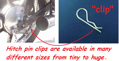

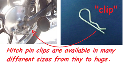

Finally, one other question. While doing some thorough cleaning before putting the exhaust back on, I noticed something strange with the rear axle. :blink:
Anyone know the proper size and grade of the cotter pin I should buy?
Attachment DSCN0145.JPG not found

- Posts: 18564

- DigitalRider
- Posts: 20
Re: '81 KZ750 - Project for an Aspiring Greasemonkey
05 Mar 2012 00:15
Thanks for the tip. I considered a hitch pin, but didn't want to take a chance until I knew for sure.

- Posts: 18564
- Thanks: 2103
05 Mar 2012 00:24 - 05 Mar 2012 00:25
Not only quicker to remove and install, and re-useable, a side benefit is that hitch pins are much less likely to draw blood when wiping down the bike.
