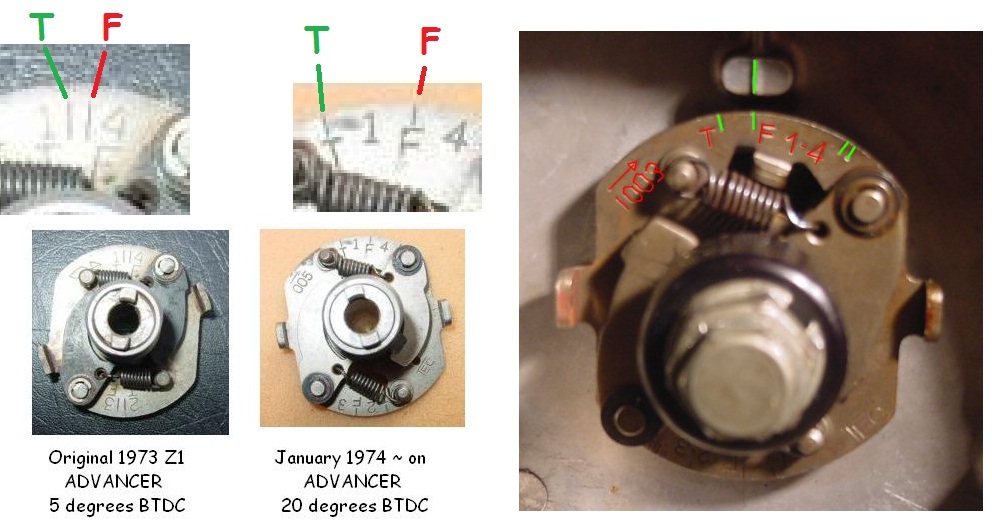

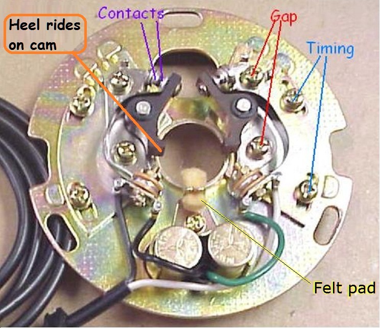

Procedure is to first set gap on each set of points. "Dress" the contacts with fine sand paper if needed, assure the contacts are ultra-clean.
Next step is to set the timing on each set of points. Use a strobe type timing light to align the F mark with the case mark.
Assure the timing advancer is functioning properly by watching it move quickly back and forth as rpm is varied by blipping the throttle. Lube the advancer.
The advancer should NOT be rusty like this:
Points at the 3 o'clock position serve to ground and unground the coil firing inside spark plugs.
Points at the 9 o'clock position serve to ground and unground the coil firing outside spark plugs.
Opening of the contacts is the event that causes the coil to fire.
