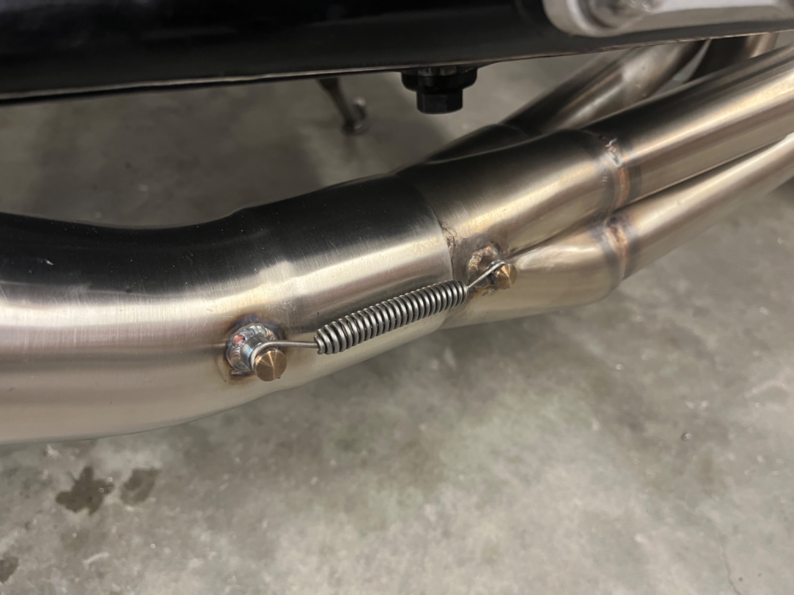

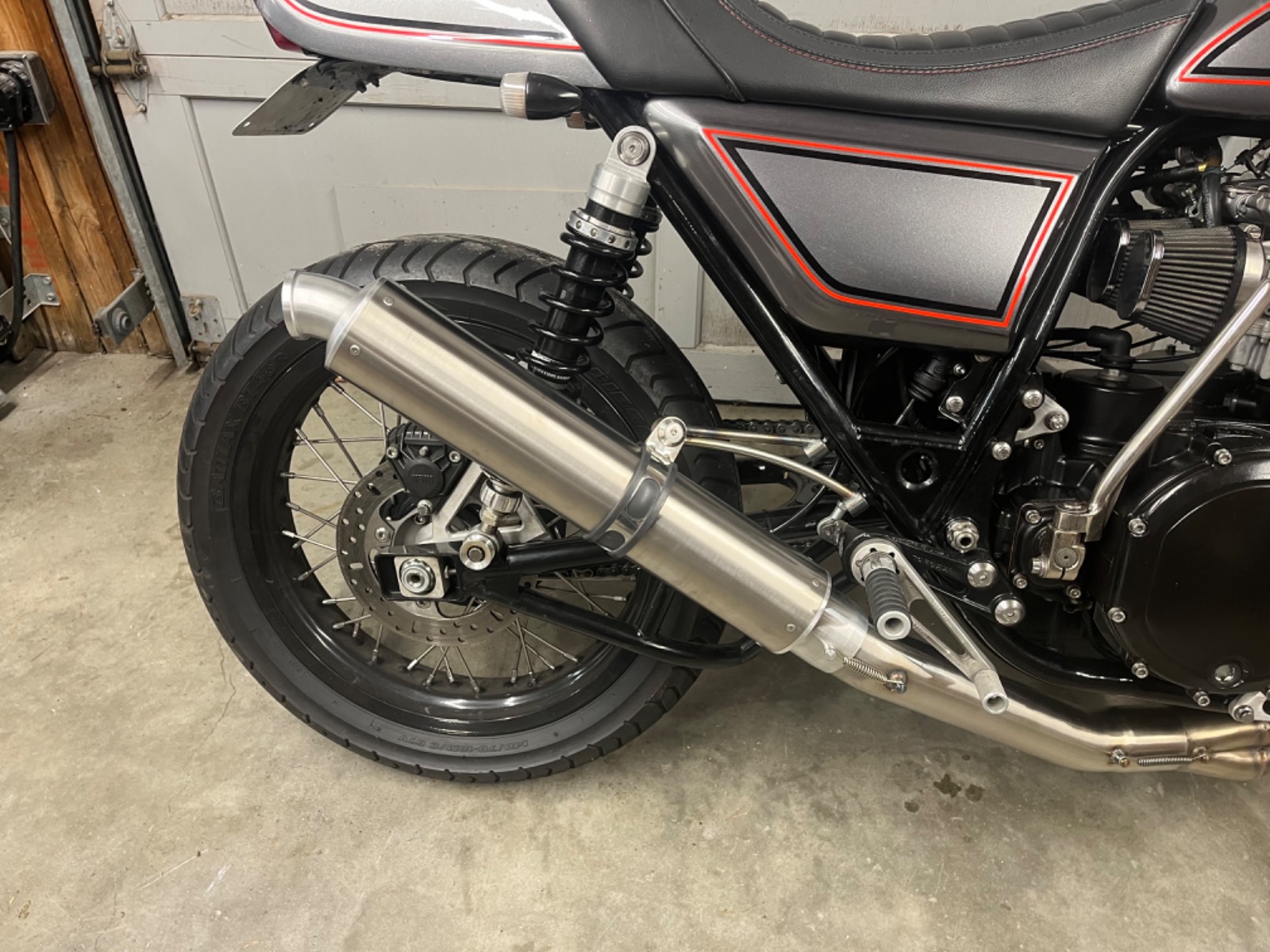

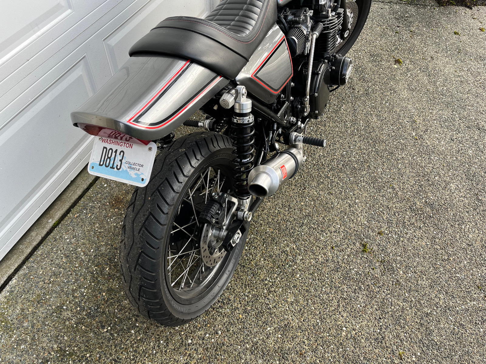

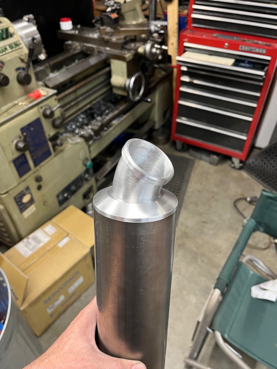

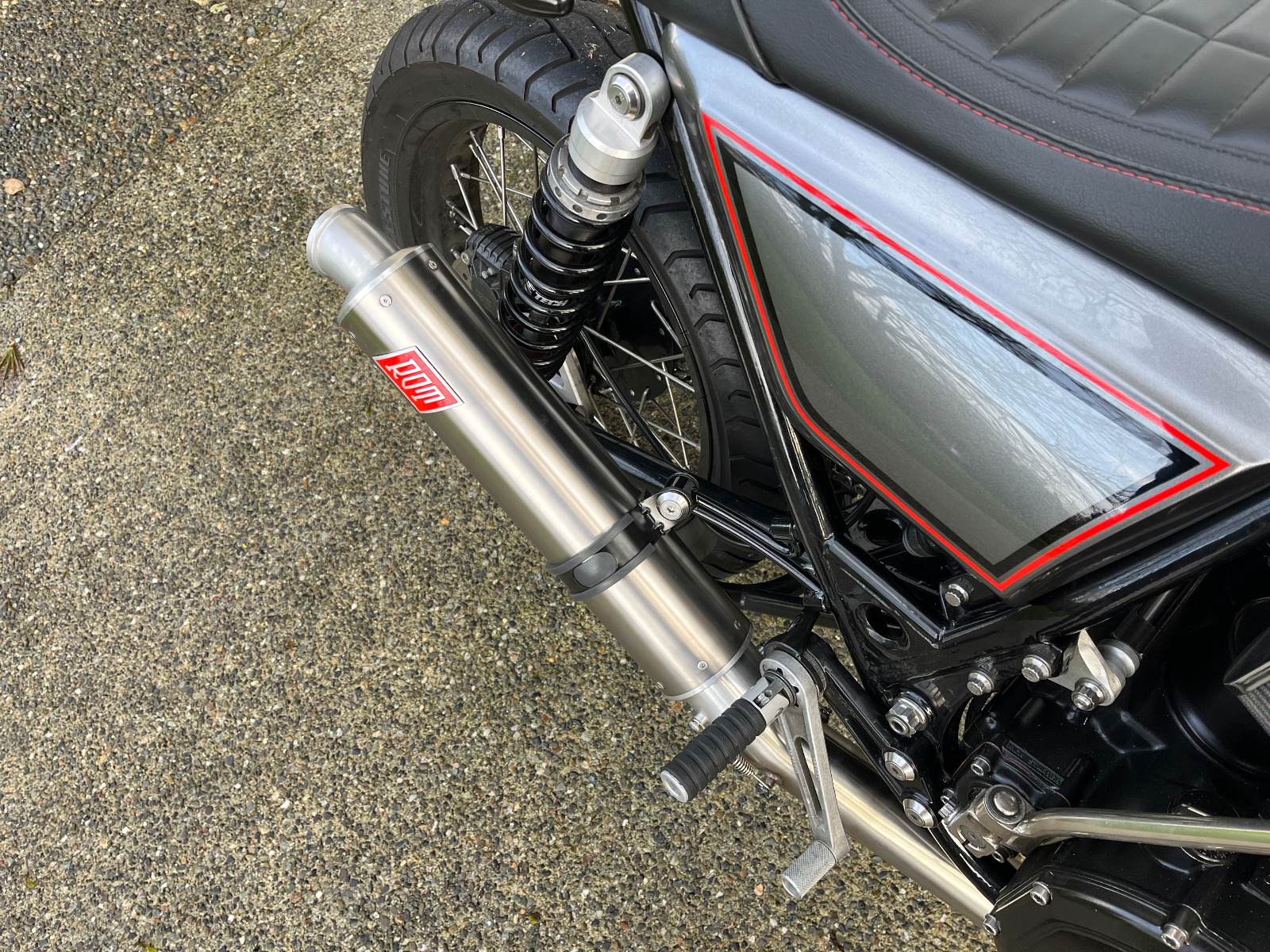

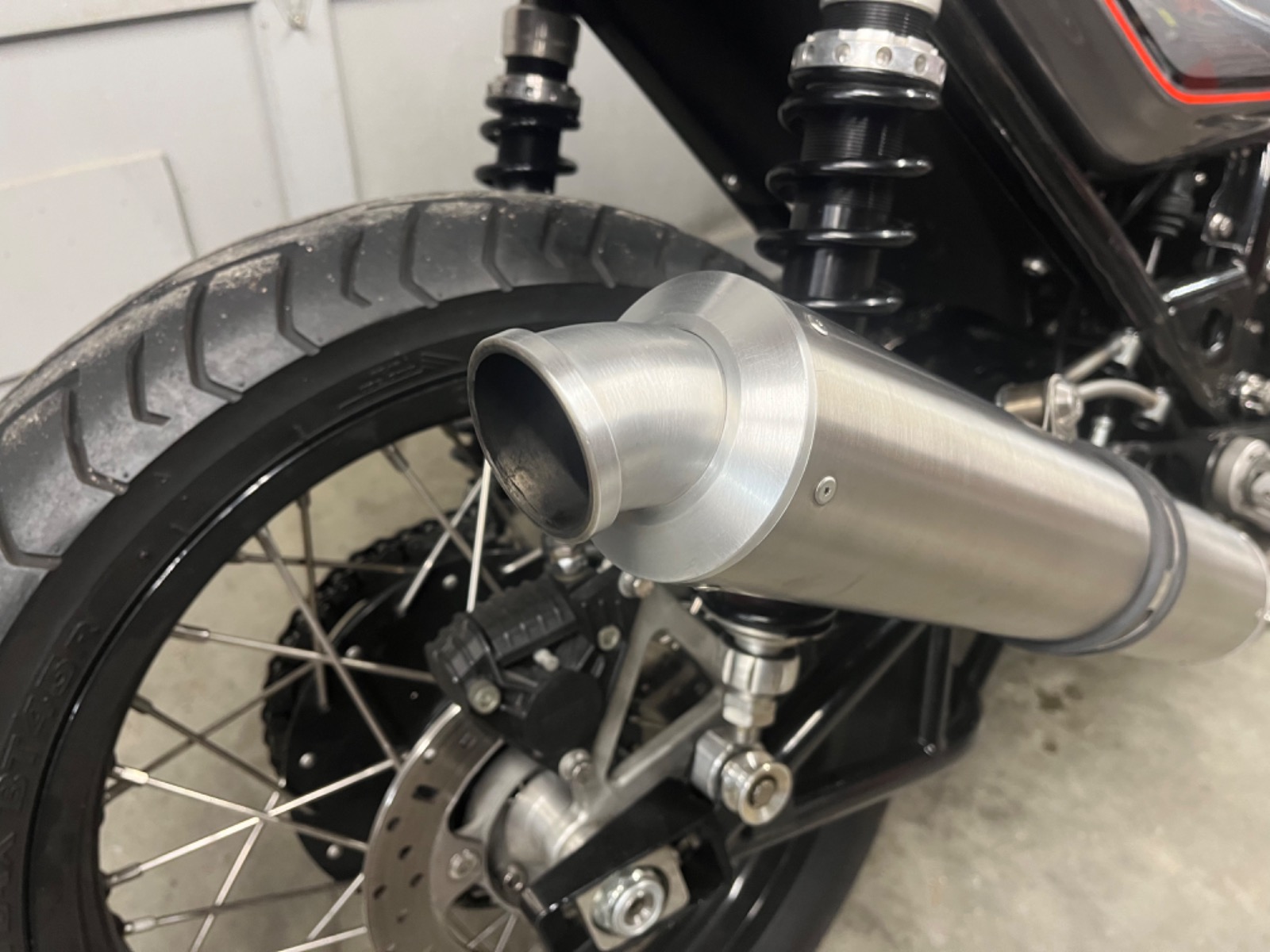

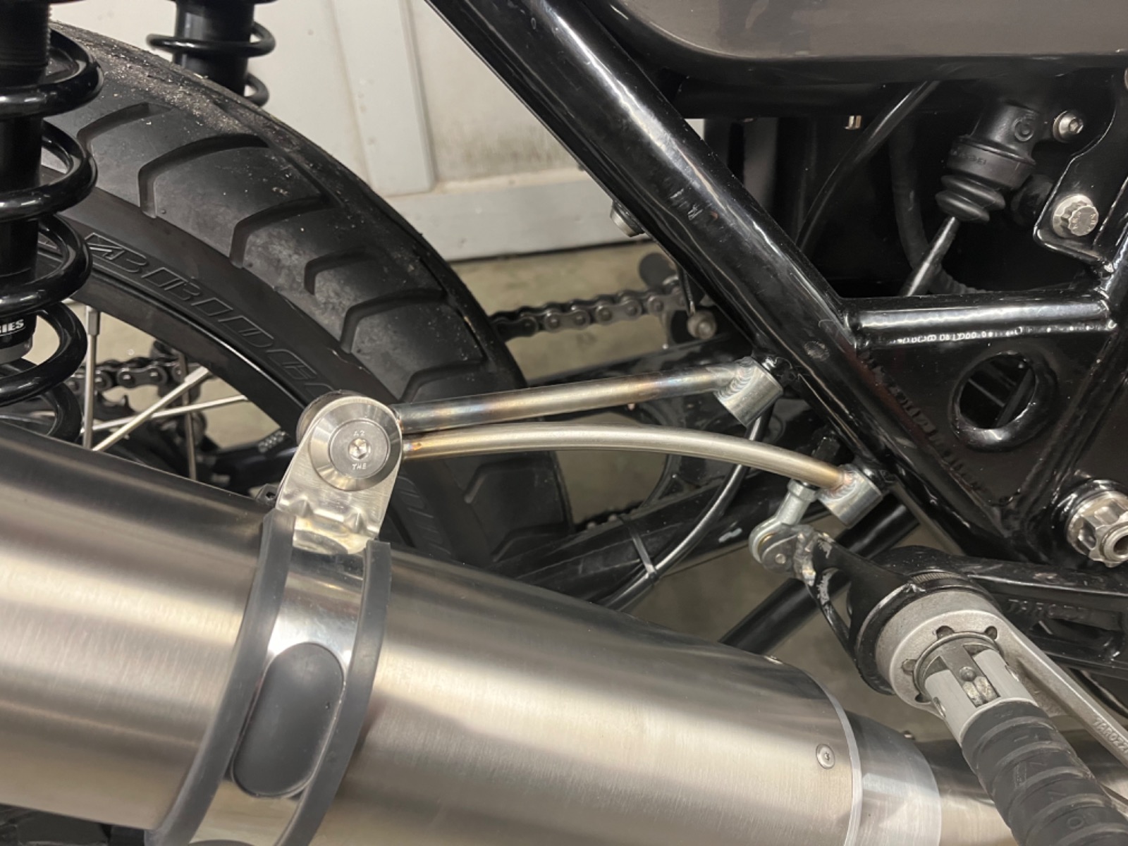

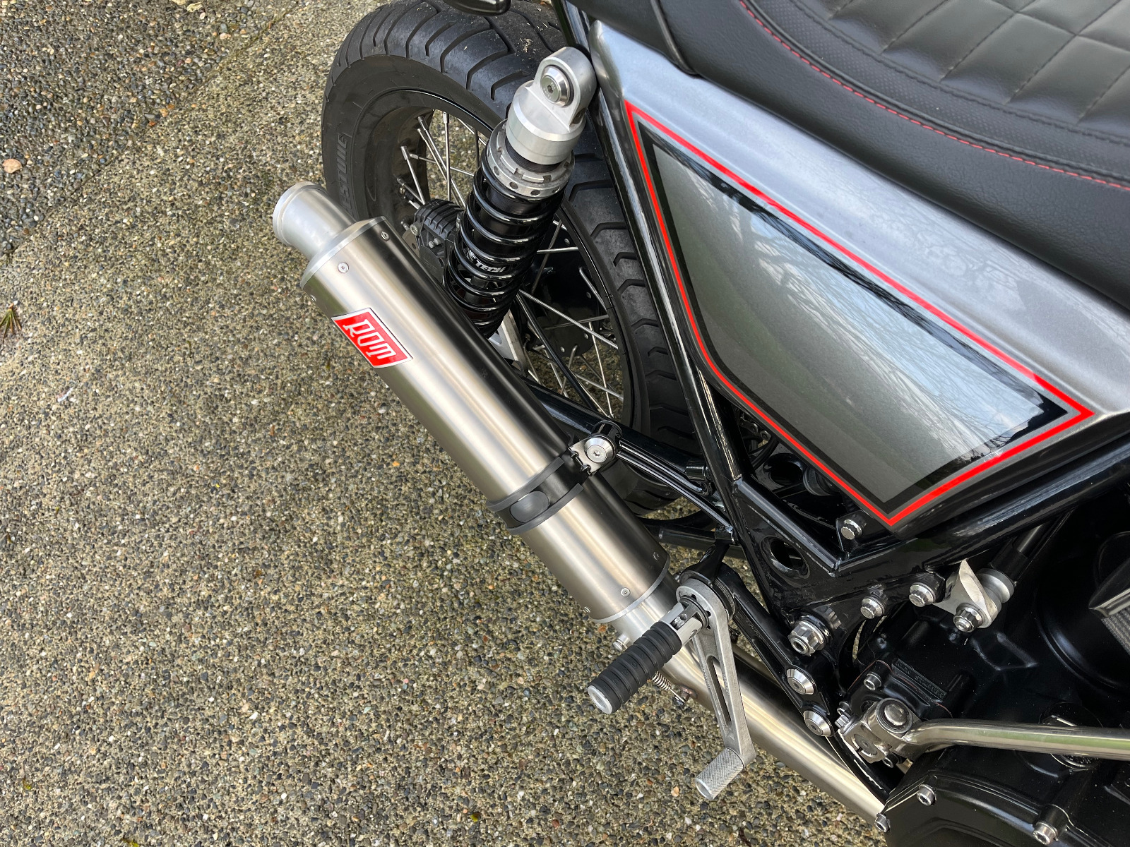

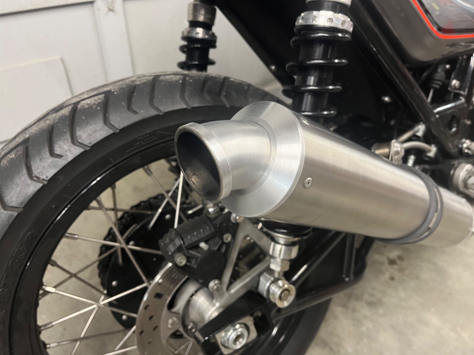

Titanium can, aluminum ends, Stainless mid pipe. I welded the aluminum internally and polished it back so no visible welds. Still need to paint the hanger.
Before : 83db idle / 107db @5kRPM
After: 74db idle / 95db @5kRPM

Absolutely stunning!

Sensational work!

Very nice. Someone is good with the tig. I need to practice more.

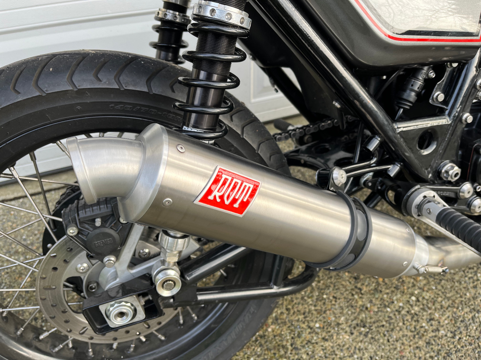

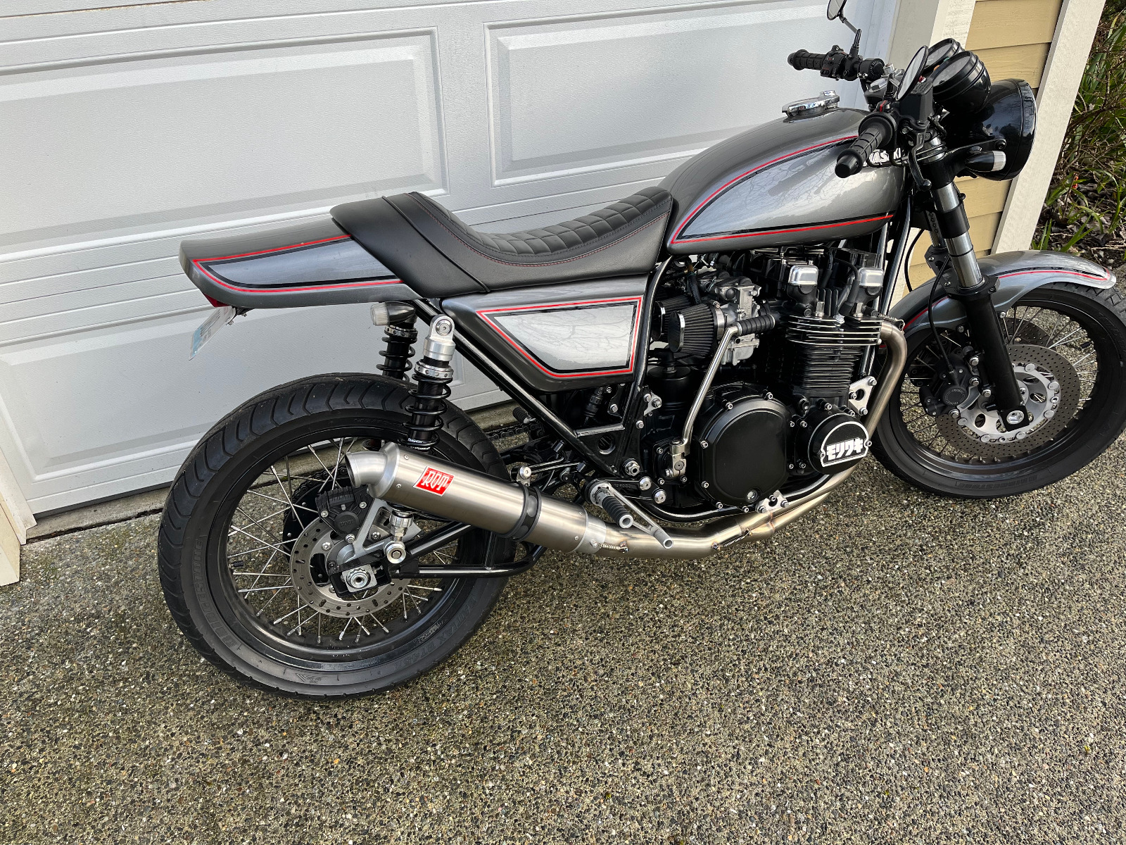

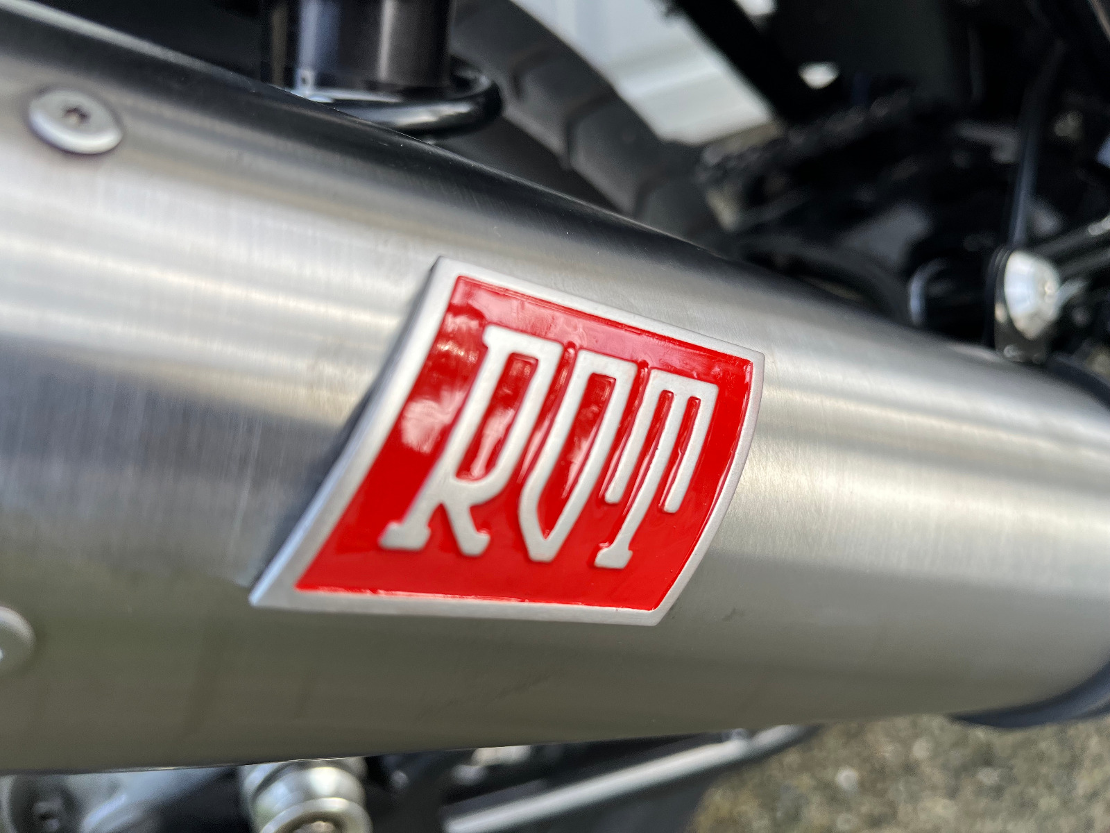

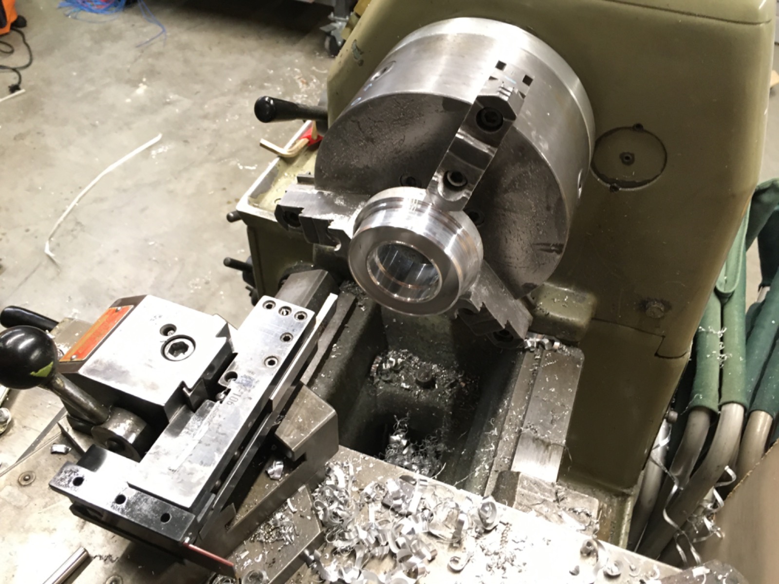

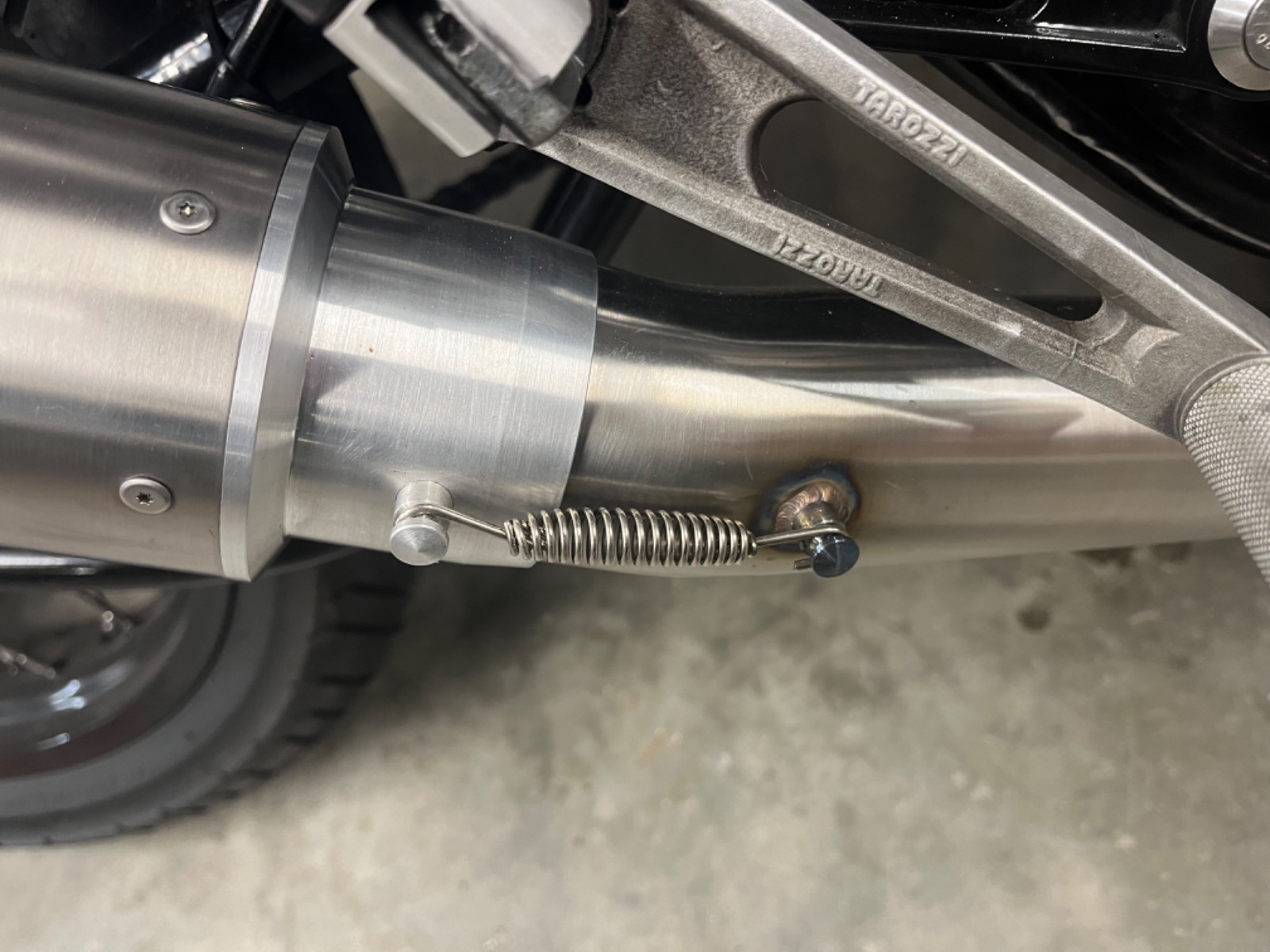

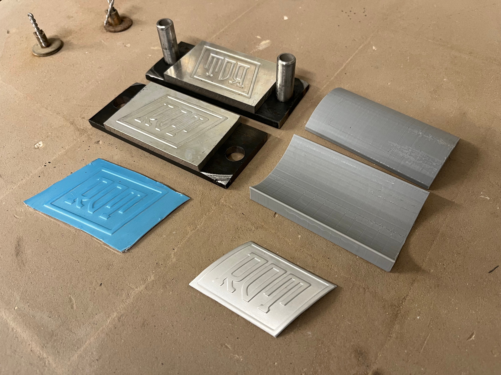

I shortened the can 3". Had to remake the hanger because the shorter can threw the proportions off. Also finally got around to designing some branding and making a badge - magnesium dies for logo with 3D printed die for curve.

Outrageous skills, check.
Bitchin' logo, check.
I'd say you're ready to hang out your shingle and start selling custom bikes and tee shirts.
BTW, what did you use for the red background on that badge? It looks amazing.

09 Feb 2024 18:43BTW, what did you use for the red background on that badge? It looks amazing.
