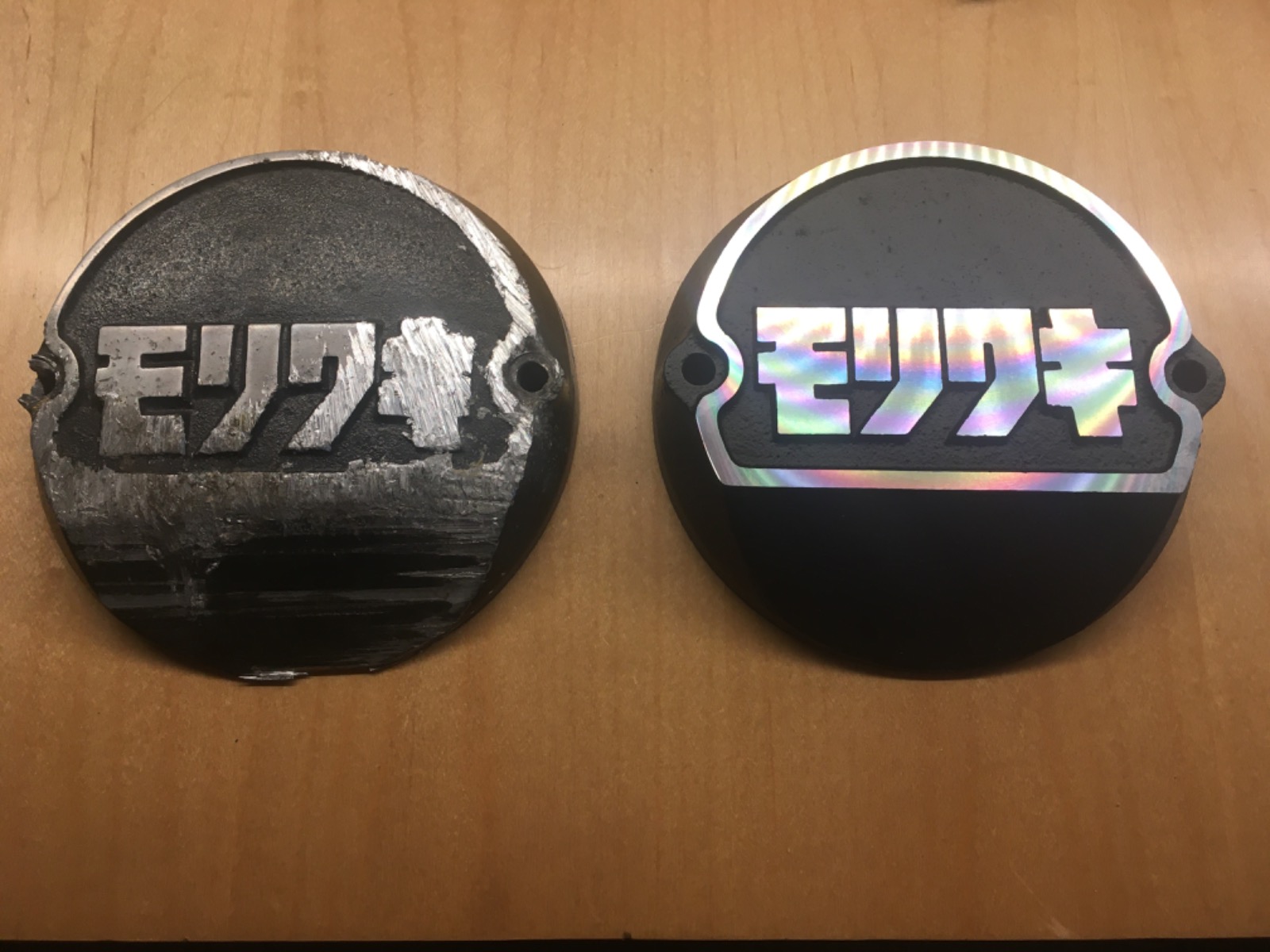

Webike is amazing. I ordered this on Tuesday. Shipping was only $22 from Japan. Got here today. Interesting how the casting evolved since the last one. The bosses around the bolt holes are thicker and it seems beefier overall.

Your old one looks like it's lost a little weight!

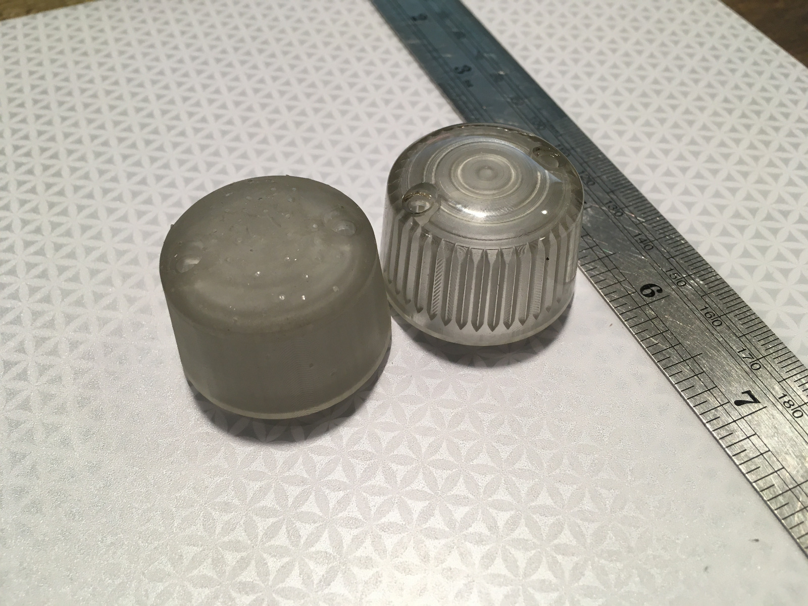

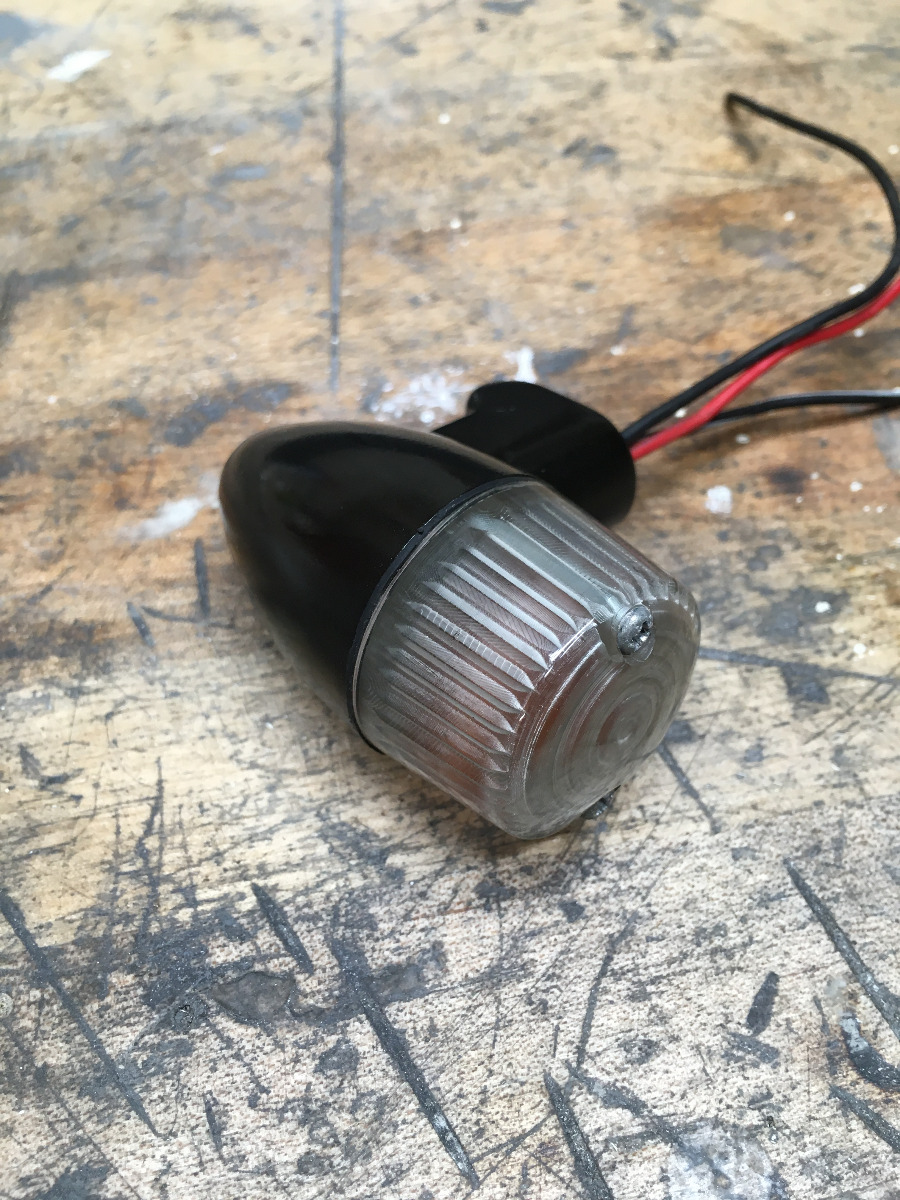

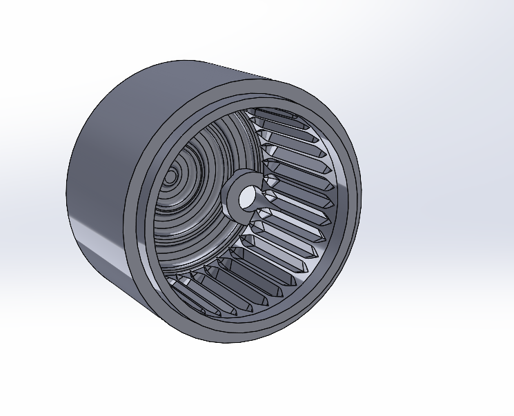

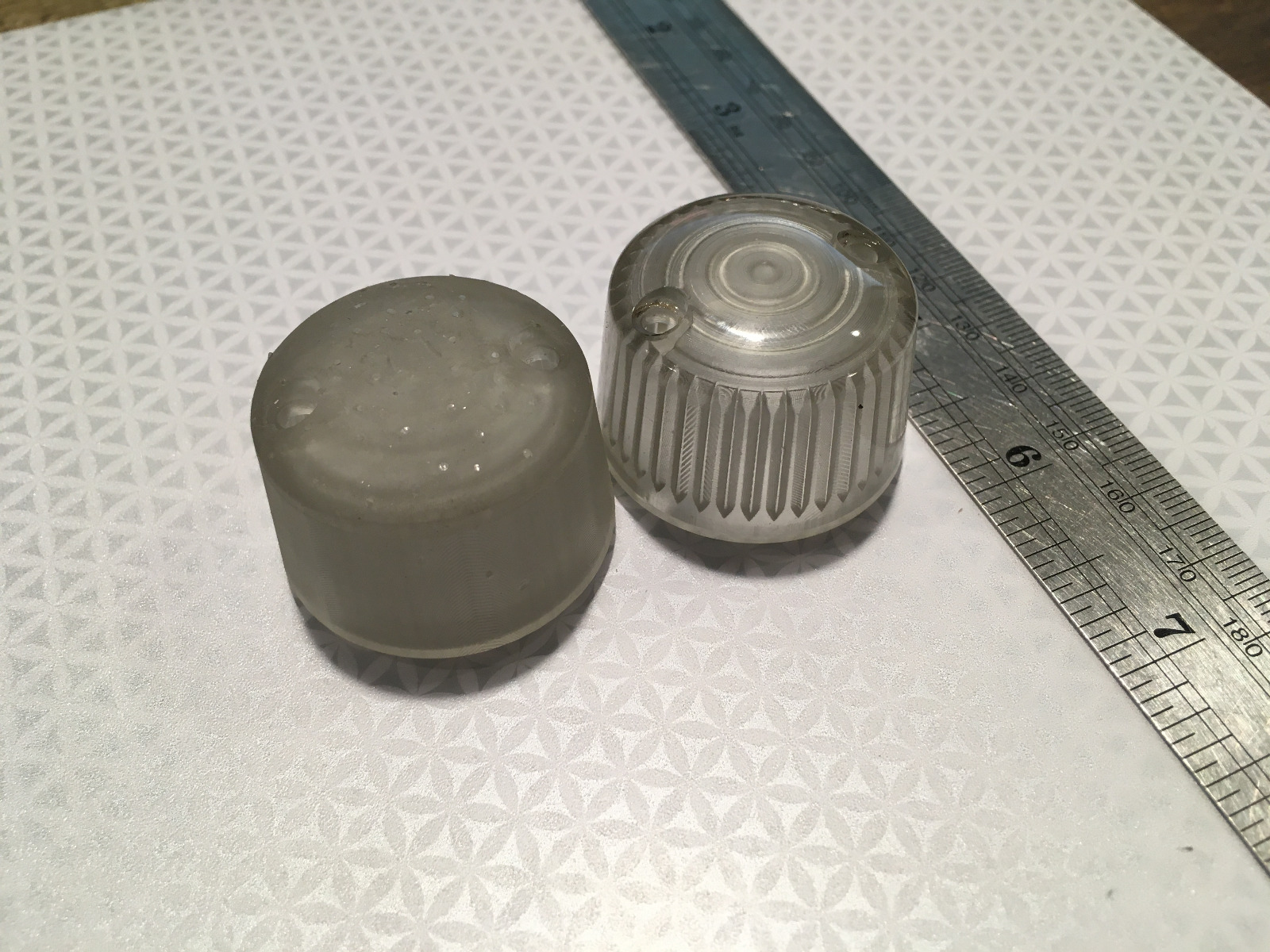

I have wanted clear turn signal lenses for a while but i couldn't find any offered for these turn signals so.... I modeled a new turn signal lens. My friend printed em up on his desktop resin printer. I then polished the exterior on the lathe. Its amazing how far this technology has come in the last few years.

Nice looking piece's

Awesome work!

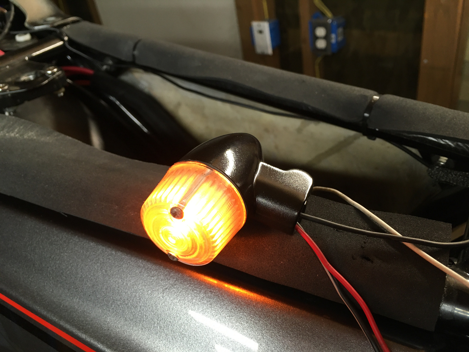

Tinting that clear resin with red, green, blue or amber will allow re-manufacture of just about any automotive lens, and indeed those pesky neutral indicator lenses that fade from green to nasty brown!
As far as 3-D printing goes, I believe the adage: "You 'aint seen nothin' yet" holds true!
3-D printing Titanium, Stainless Steel or Brass is now commonplace, albeit with a different process.
Although currently, the cost of these metal printing machines is prohibitive for DIY, I believe prices will eventually reduce such that we will have them in our man-caves!

Nice! and the turn signals are class, modern solution to an old problem.
