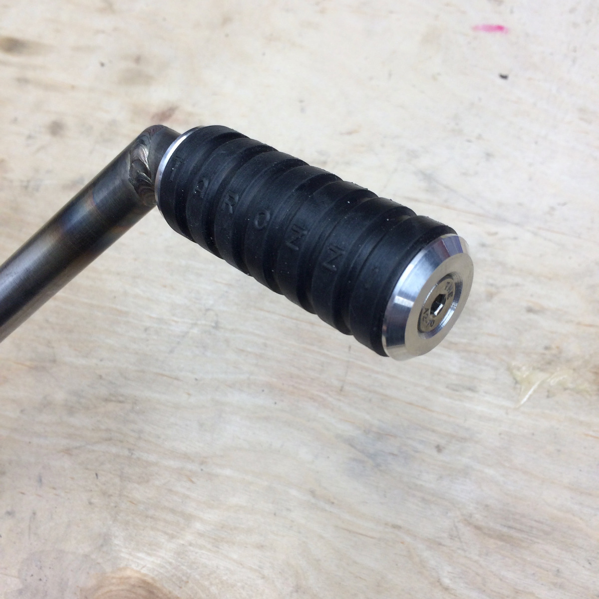

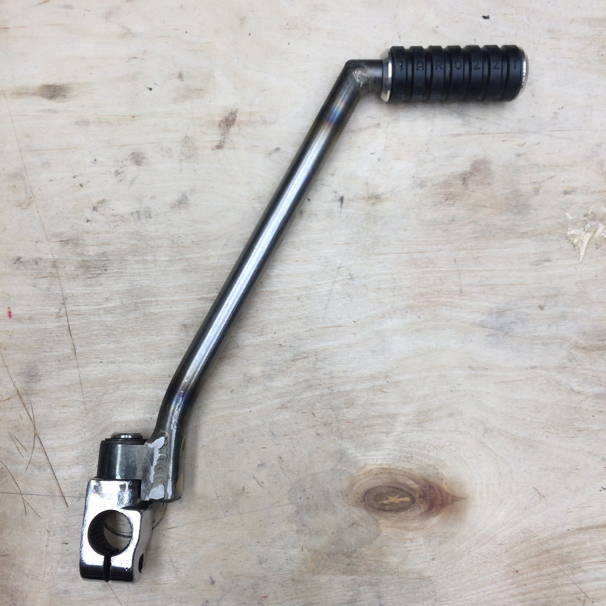

Custom chromoly kick lever for extra clearance. I also machined some bits to accept a Tarozzi rubber to match the foot-pegs. Needs final polish before going to plating

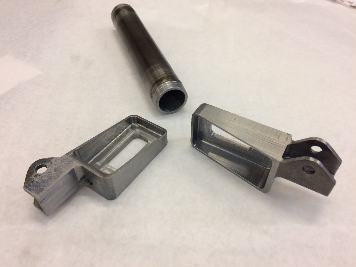

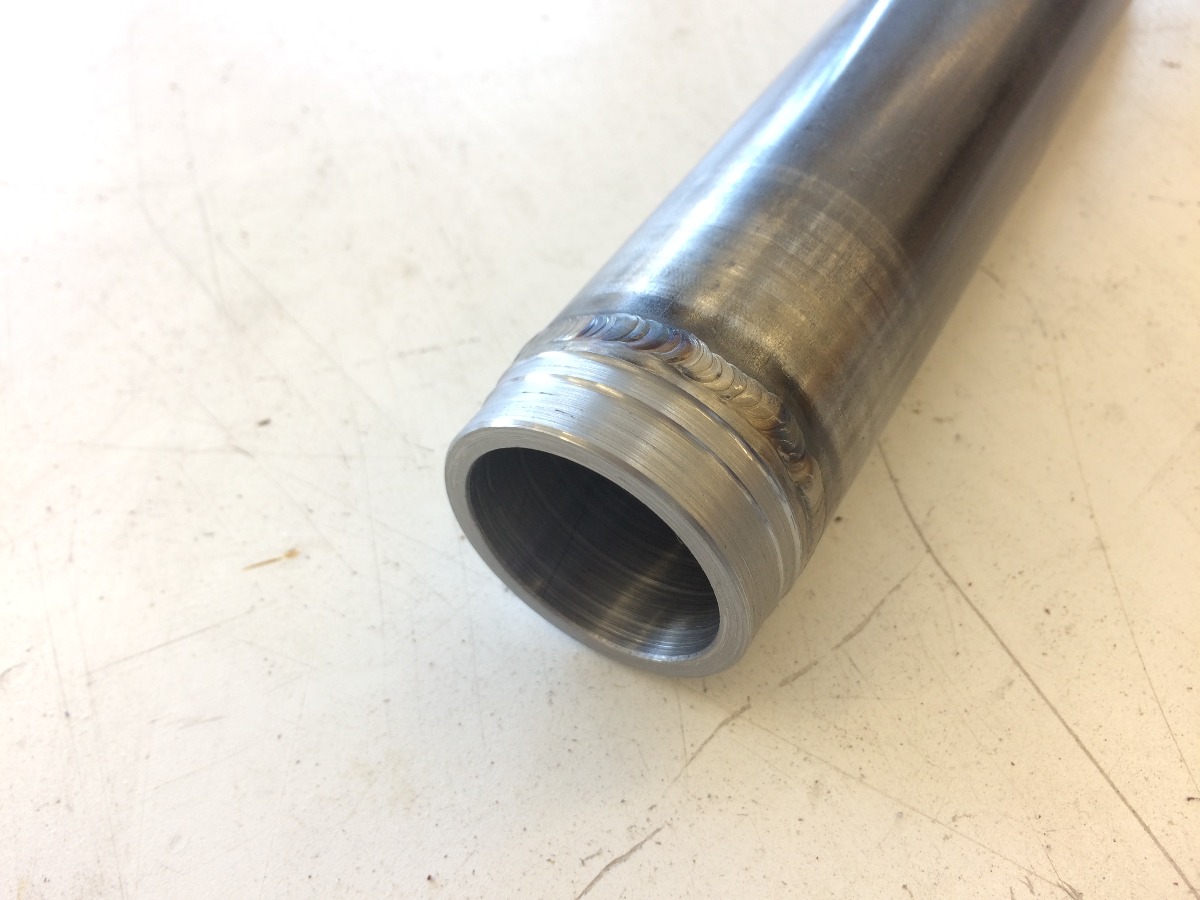

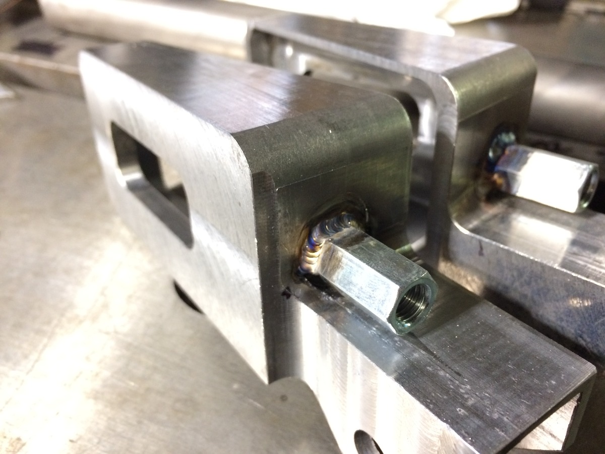

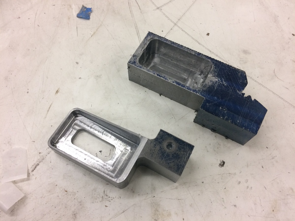

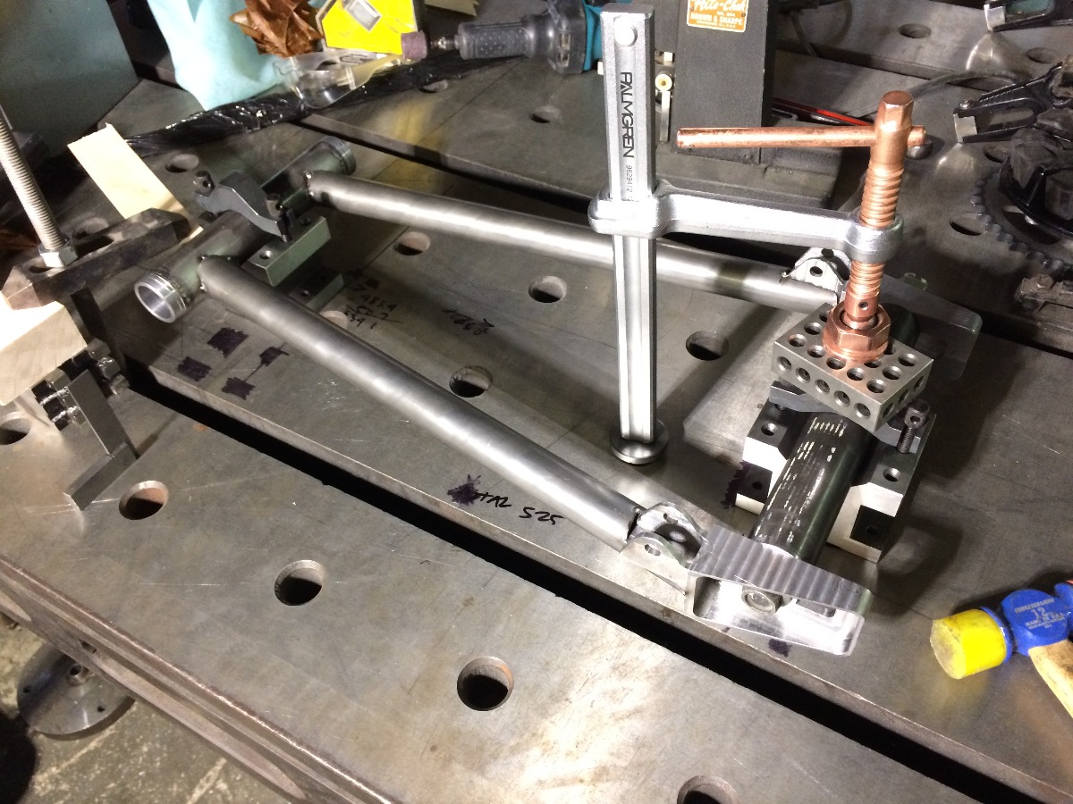

I have been invited to show this bike at The 1 Moto Show in Portland Oregon. So I decided to finish some upgrades I wanted to do from the beginning but shelved the ideas to get this bike on the road. School is finished for the semester so I have no access to the shop, but the show is in 5 weeks so I needed to make progress. Luckily I have cool friends with badass shops that are willing to let me use their tools to get this done. I have been working on a custom 1.5" over chromoly swingarm that is nearly finished. I machined the adjusters and pivot from scratch. Its a little a-symmetrical to deal with chain run, its not perfect but its a good first effort. My buddy recently bought a giant mill table (10'x4') and had it precision ground flat, which is what I used to setup the swing-arm layout on. I also am doing a custom rear brake setup, to ditch the heavy stock parts. I found a rear rotor off a '98 ZX6R and machined a carrier to adapt it to the rear wheel. I'm going to use a tiny Grimeca rear caliper to match the front calipers.
