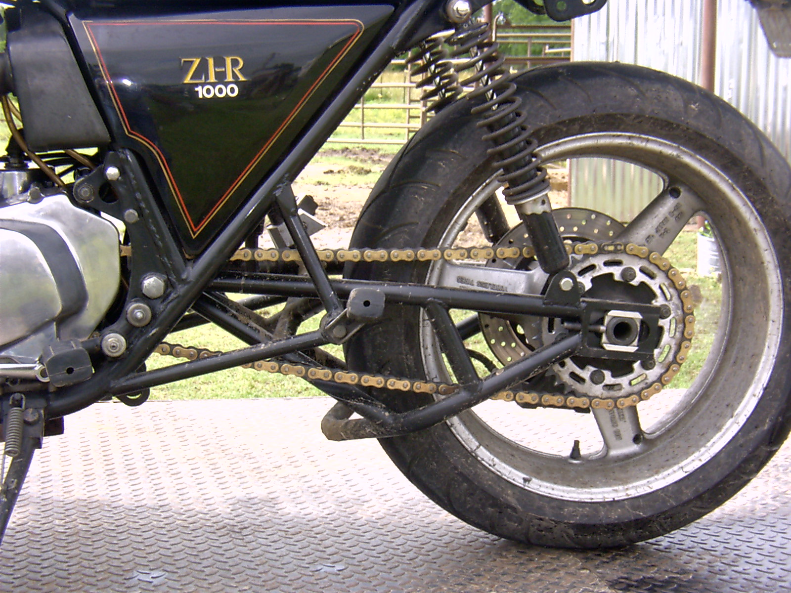

OK all the halfaxx research I have done on the swingarm 180 tire fit hasn't been the best. ok I get click happy on Feebay. the swing arm inside dimension is 9.5" wide at the axle. my new click happy wheel came today 9" from end of stud to rotor side bearing 1/4" spacer on each side? what about brake assembly? Not gonna work is it? What do I do? spring for a wider swingarm?

got an email from spaceballs on youtube he says his swingarm is the same inside dimension as mine I know a GS1100 is an inch wider and is easily convertable I am waiting on my axle and rotor to get everthing mocked up but I think I am gonna have to go wider on the swingarm I have included a couple more pic's and welcome any ideas about using what I have. the brake caliper is gonna be a problem and looking at the gs swingarm it apears to have a slight offset to center wheel If anyone knows this setup wont work I would appreciate your insight.
thanks for any help

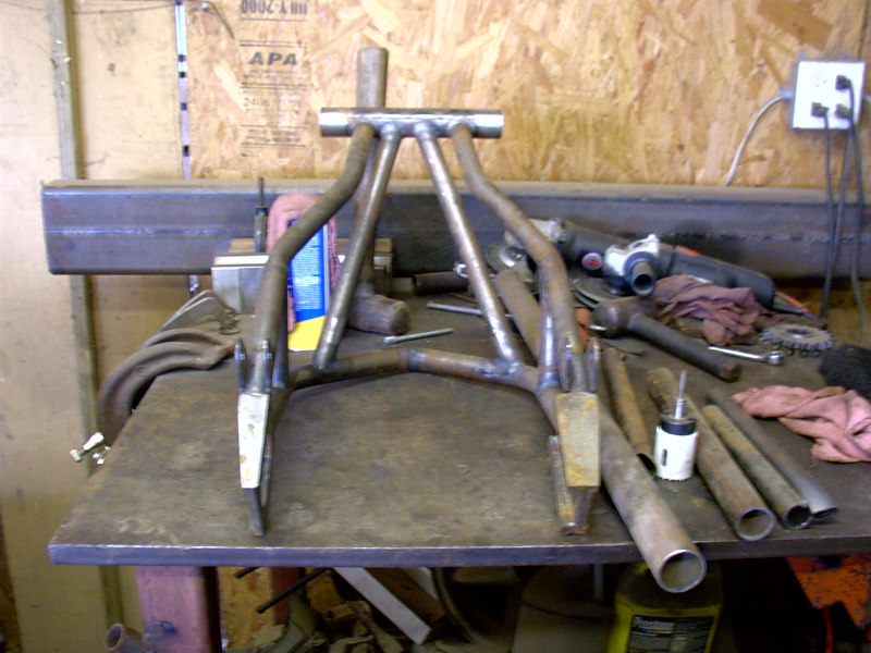

i "think" i have a zx9 swingarm that i am milling .150 thsnths. off the pivot tube to fit a kz900.
which if i am correct (that it is a zx9)means that the zx is 9.150 wide.
where the kz is 9 inches wide.
i took the easy way out(for me),and just built my own swingarm to suit my uncompromising taste :evil: .
