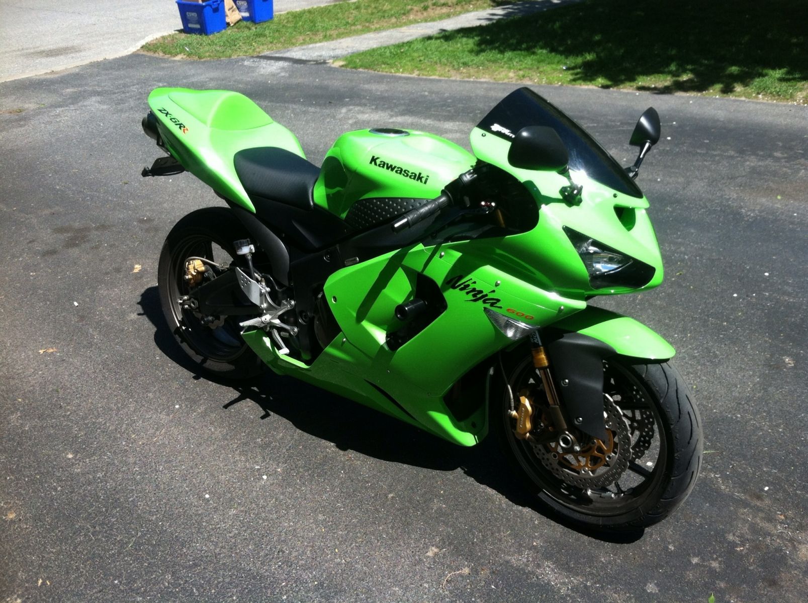

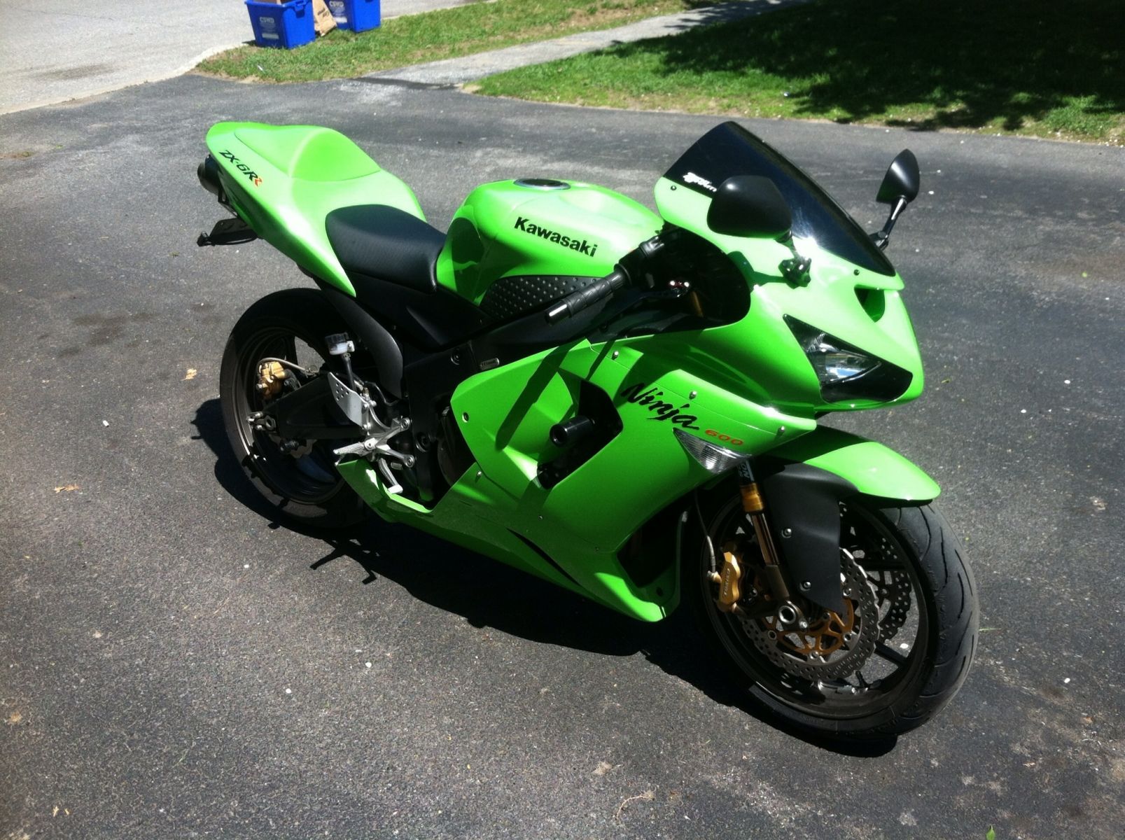

Your rearsets look like the stock ones off of my old 05 zx6.
And the heel guards look a lot like the sato racing rearsets that I had on it too.

I like your rear set adapter plates. Are you happy with the location of your rearsets? I am no machinist but a friend of mine just got a mill and one of the things I am thinking of trying to make is plates like you made. I never had adjustable rearsets until the Sato's in my picture but it was awesome to be able to change position and check it for comfort immediately after. Did you mess with the positioning of yours when you made them? It seems like it would be just as easy to make a set of adjustable adapter plates with a bunch of different holes and settle on exact position after the fact.

Yep I'm happy with the position. If you look far enough back in this thread I had built some steel rearsets that didn't work out perfectly. Those did teach me where I wanted these to go. Also I have a ZX-10r that I can always jump on to get a quick idea of riding position. Obviously this bike is a bit different as I want to be sitting more upright. Also you could make adapter plates with multiple holes that would allow you to change up the position. It will take a bit of calculation to get your hole positions right so that the rearsets line up correctly. I say go for it. Aluminum is fairly cheap and it is a forgiving material to learn on the mill with. About the only thing that machines easier is brass.
BTW the rearsets I'm using came from a second gen ZX-10r. Hence the similarity to your ZX-6r. And thanks for the kind words.
