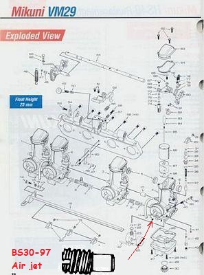

Forgive if already mentioned, but this cleaning method works well on smoothbores.
The small air jet is easily overlooked, and is removable for cleaning.

Thanks Patton. That air jet is a small bugger. I should be doing this tonight if I get time.

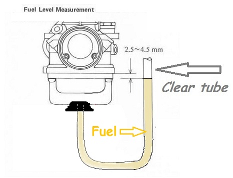

I guess that the ballpoint pen trick won't work on these float bowls for the clear tube test.

21 Apr 2011 08:18testarossa wrote: ...Still need to do a bench sync, and adjust fuel level...I guess that the ballpoint pen trick won't work on these float bowls for the clear tube test.
Handsome carbs!
Could use a modified drain screw:
www.z1enterprises.com/detail.aspx?ID=4341
Or fab your own.
And might also find on ebay.
I get by just fine with a tube inside a grommet (cone-shaped if available) pressed inside the drain hole:

just remember to mark the tube. this way the same amount of fuel comes out of the bowl each time and the results remain accurate.
