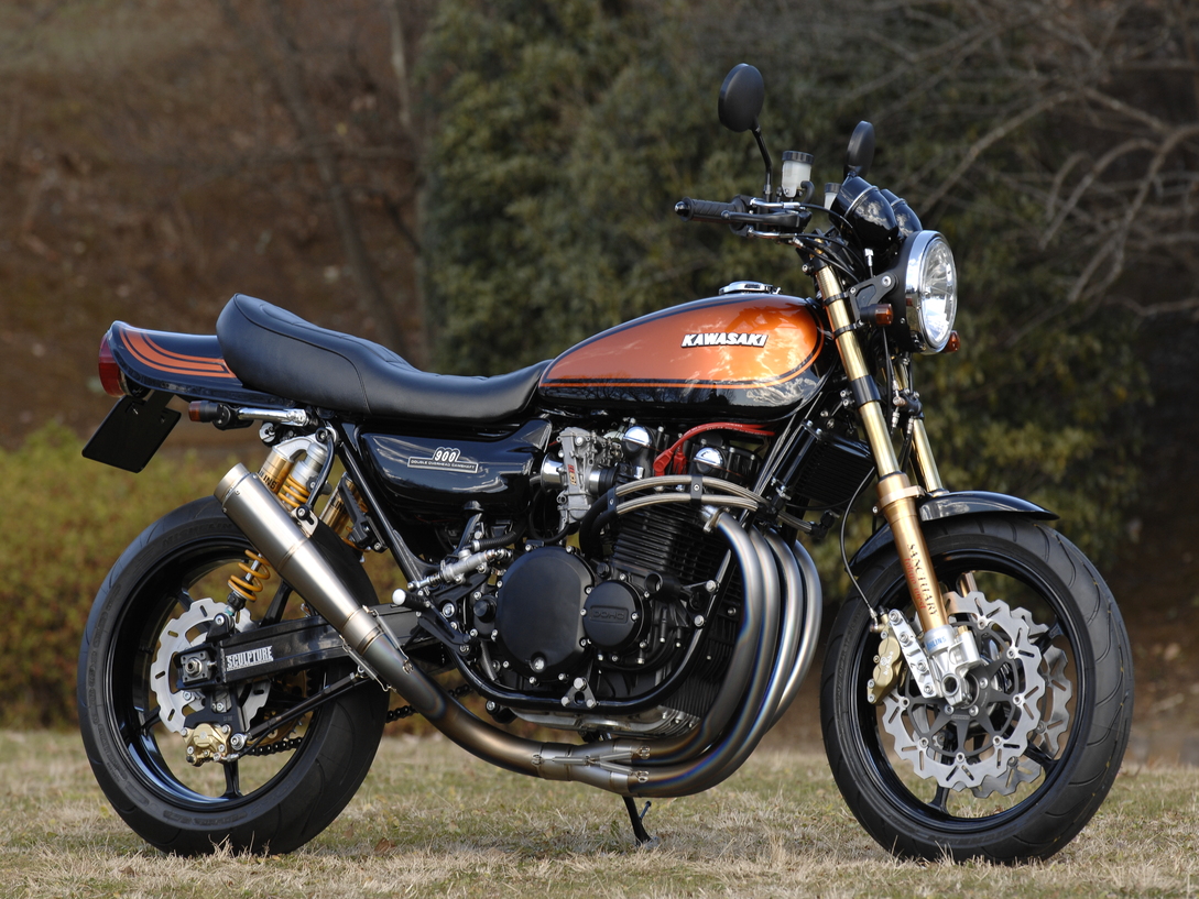

16 May 2011 11:37 - 16 May 2011 11:44 #451437 by 531blackbanshee
Replied by 531blackbanshee on topic Testarossa's 78 KZ1000 Fighter Build
i like the way they sculpted the seat on these two.

16 May 2011 21:19 #451581 by Nelson
Replied by Nelson on topic Testarossa's 78 KZ1000 Fighter Build
dang! those are some sweet 900s. where did u find those pics? I want to know more..
uh, oh yeah - Nice job on the rearsets too.:cheer:

16 May 2011 23:31 #451618 by testarossa
Replied by testarossa on topic Testarossa's 78 KZ1000 Fighter Build
Leon is like the Hugh Hefner or Larry Flint of KZ Porn. He's all the good pictures. :whistle:
