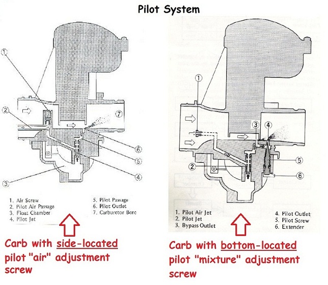

While the air screw vs mixture screw carbs have slightly different pilot circuits (first image), the cleaning method (second image) illustrates the same principles to be used on either.
Please wear goggles when spraying carb cleaner, as it will invariably backfire into the eyes.

24 Mar 2011 08:18Patton wrote: Am thinking richer pilot circuit mixture should result in a cooler running cylinder at lower rpm range.
Hopefully, perfecting the pilot circuit will resolve the stumble.
I thought so too. As a matter of fact, I started by turning that screw in (leaner) which resulted in cooler temps still. Another half turn in resulted in 200*F. So I suspended my disbelief and started turning it out. (richer) Lo and behold, the temp started to come up. I guess that the amount of fuel getting through at idle was so low that I barely had a fire in that cylinder. Once I got that screw out a full turn or so, the temp was running 500* just like the other three cylinders. It shouldn't be normal to have three cylinders with the mixture screws at one turn out, and one at two turns, right?
