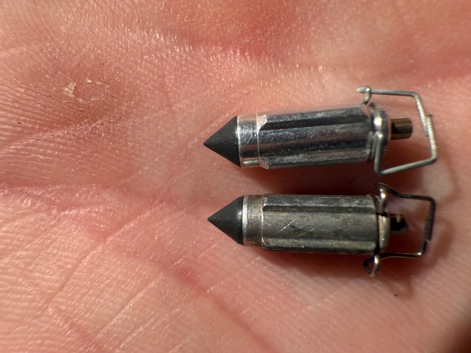

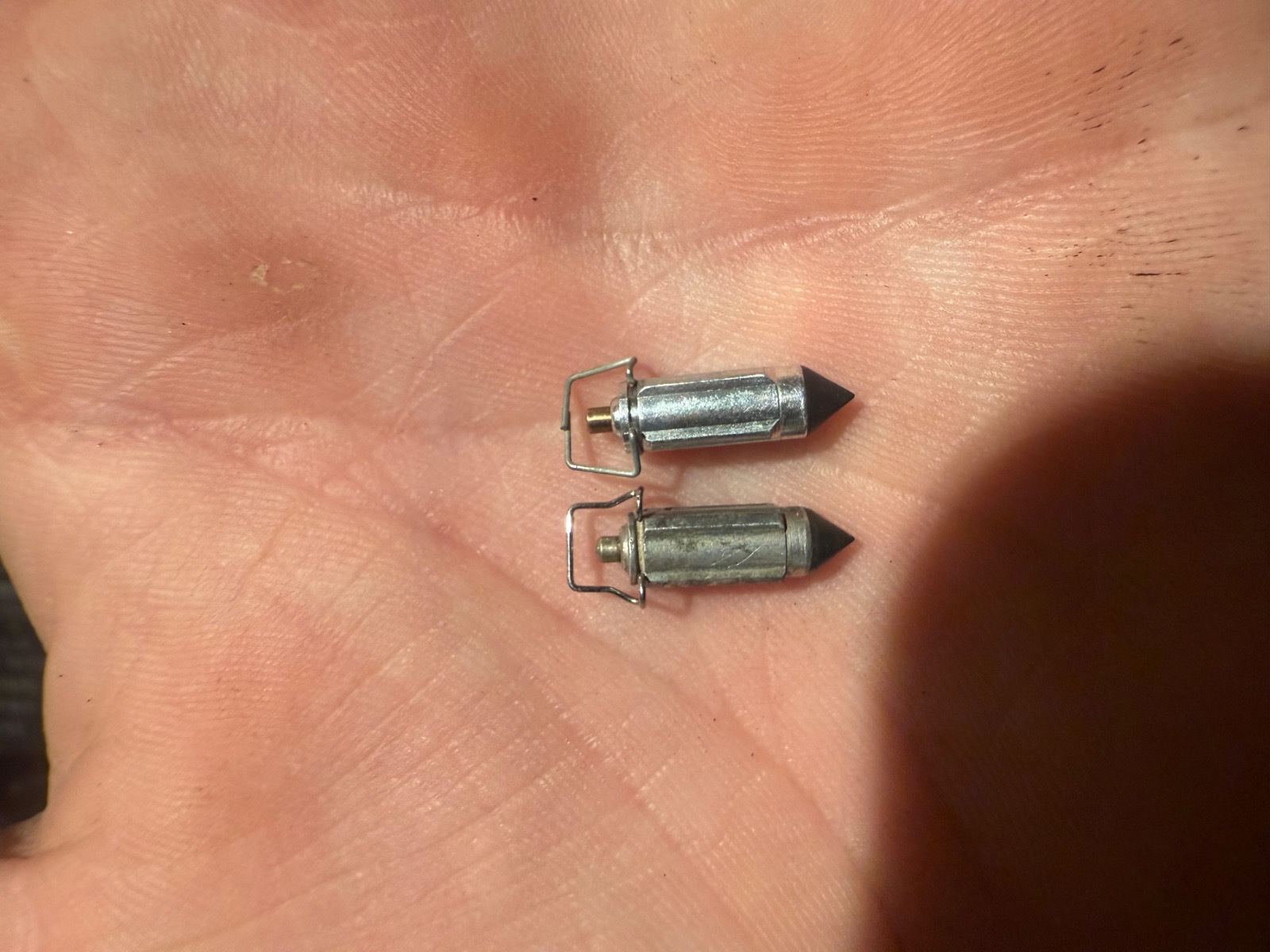

I took the carbs apart tonight, and comparing that float valve I have in there with the last one it looks slightly different. Mostly just the springy button on top appears to be longer, stronger, and a different color. The runner part looks like it’d work the same but still looks slightly different. I don’t see how it’d be a problem given my float test showed the correct level. But maybe I’ll have to order new ones or just use my old ones since they look fine. Maybe it’s when the engine is running that float valve struggle from vibration. Idk. I’ll try to upload my pictures I took of them. I got the rebuild kit off eBay from a Japanese seller called “Crusinimage” so maybe some of the kit is wonky.

I cannot say whether cruzinimage carb parts are of good quality but generally people here have had good luck with their engine parts. The cruzinimage float valve looks like it should work fine. The extra length for the spring should be compensated by checking the fuel level (which you did) and if they werent sealing you would know.
Im a little worried that the previous jet needles were bent How does that happen?!?? PO must've learned to fix things with a hammer... what worries me is that since the jet needle was damaged, the needle jet is also damaged, which could be causing it to run rich.

If you have the carbs off the bike at the moment and want to check if the float valves are doing their job then turn the carbs upside down. Remove the bowls and blow into the fuel line. By mouth. Not compressed air. If all works as it should then it takes a lot of puff to lift the float. If the valve is not sealing then you will know pretty quiclkly.. probably dirt in the seat in which case a Q tip dipped in Brasso will polish it up. Rinse off with carb cleaner and test again

12 Jul 2026 20:13Yes it appears I had problems all over the bike which is good for teaching a newbie about these vintage bikes but I just want to ride it finally.. haha. the PO didn’t make it easy for me. I think you actually hit right on the money with the contact points more. I replaced actual points right after the rebuild assuming that would take care of things. As an inexperienced mechanic I did not even check the advanced timing mechanism behind the plate. It had old crusty grease and rust on it so when I twisted it to test operation the springs couldn’t even return the weights. Since I had trouble finding another used mechanism, I just cleaned it with blue scotch brite and brake cleaner. The springs also looked stretched out so I ordered new ones. Also very hard to find but I read that springs from an xs650 would match. Cleaning and greasing solved most the problem to allow smooth twisting but the new springs allowed the weights to snap back quicker. Another thing I did was test the condenser with a multimeter and it showed 0 ohms so it wasn’t doing its job. I just got that part so I will install the new condenser, get my timing right, replace spark plugs since the last ones are fouled with fuel, and then change the oil the last time... And I’m hoping to see a stronger spark and no more fuel slipping through. I’ll update soon thanksI cannot say whether cruzinimage carb parts are of good quality but generally people here have had good luck with their engine parts. The cruzinimage float valve looks like it should work fine. The extra length for the spring should be compensated by checking the fuel level (which you did) and if they werent sealing you would know.
