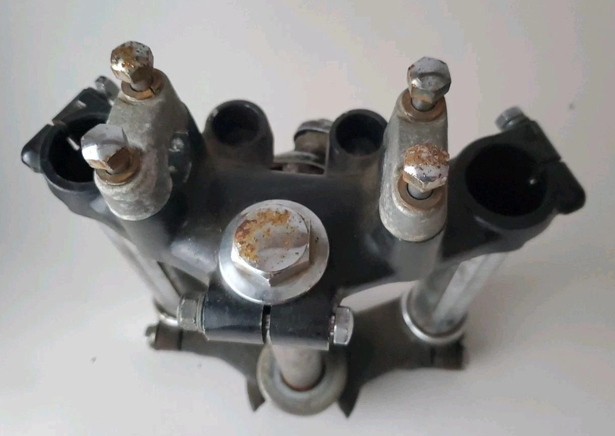

Thanks for sharing that. I checked and the CSR triple clamps appear to have a shorter offset than the earlier regular 650 series. This would mean that the CSR would have less trail than a regular 650 if the forks were the same length. Since the CSR forks are much longer, replacing them with the regular shorter forks would reduce trail. However, I've read elsewhere that the steering stem angle on the CSR is a couple of degrees more relaxed (less upright) than the regular 650 but I don't know that for certain. What the actual result will be with the swap remains to be seen and if it's not working then I'll have to just do something else. It's all just a big experiment for me.

21 Jan 2026 07:23You want want to put the data into the calculator on the below link and take the guesswork out of itThanks for sharing that. I checked and the CSR triple clamps appear to have a shorter offset than the earlier regular 650 series. This would mean that the CSR would have less trail than a regular 650 if the forks were the same length. Since the CSR forks are much longer, replacing them with the regular shorter forks would reduce trail. However, I've read elsewhere that the steering stem angle on the CSR is a couple of degrees more relaxed (less upright) than the regular 650 but I don't know that for certain. What the actual result will be with the swap remains to be seen and if it's not working then I'll have to just do something else. It's all just a big experiment for me.

11 Feb 2026 20:54Thanks for sharing that. I checked and the CSR triple clamps appear to have a shorter offset than the earlier regular 650 series. This would mean that the CSR would have less trail than a regular 650 if the forks were the same length. Since the CSR forks are much longer, replacing them with the regular shorter forks would reduce trail. However, I've read elsewhere that the steering stem angle on the CSR is a couple of degrees more relaxed (less upright) than the regular 650 but I don't know that for certain.
The rake angle on an 81 H1 is 29 degrees, 2 degrees more than the 81 D4 and 1.5 degrees more than the F2. Page 1-6 of the FSM.

Re: 1981 KZ650 CSR
