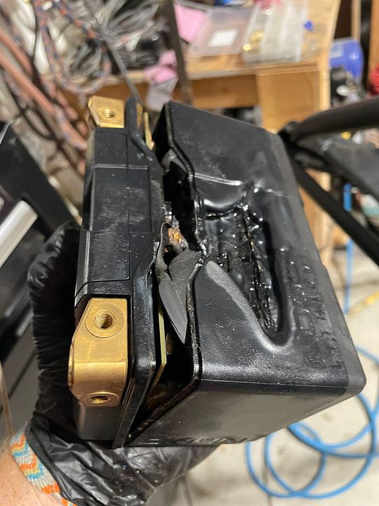

A friend put a Lithium battery into his Honda GL500 V-Twin.
I guess he did not upgrade or check his charging system, as his bike died on a ride and almost caught fire!
The battery was mounted quite low, below and behind the engine.
Probably saved his bike from burning, the engine acting as a shield.
