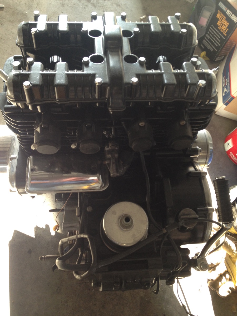

Nice looking Z! Food for thought. Quick question though, is the engine out NOW or is the pic of completeness a re-install? I have some info on the carbs if it helps the "rich" condition. Pertaining "only to the carbs" though, i do a lot of the ramp style 72-75 Z's. Are You close to Asheville, NC?
- Totaldirtbag
- Posts: 6
Re: 1973 Z1 owner from North Carolina
18 Jan 2024 09:55
Hi,
I am in Wilmington NC so its quite a way from the mountains. The bike is all together and I don't know how the pic of the engine got attached although I probably selected it by mistake. I would like the info on the carbs .... you just never know if you are missing a piece of the puzzle. The fact that all the plugs foul at the same rate and so quickly leads me to think I'm missing something obvious. Particularly since they worked fine as a set on another Z1. I don't think its a fine tuning issue but likely to be a component failure or I have hooked up something wrongly. There cannot be too many issues that affect every cylinder in exactly the same manner. It seems I am going round and round in circles on this one and its not as if I am inexperienced. Iv'e been working on my own stuff for over 50 years and never been stumped like this. I will (for the 100th. time) remove the carbs and clean and inspect the choke plungers etc. as some of the members have suggested. I' m leaving on a 10 day trip shortly so may not have a chance to do much till I get back. Thanks for your input, I really appreciate the willingness to help.
