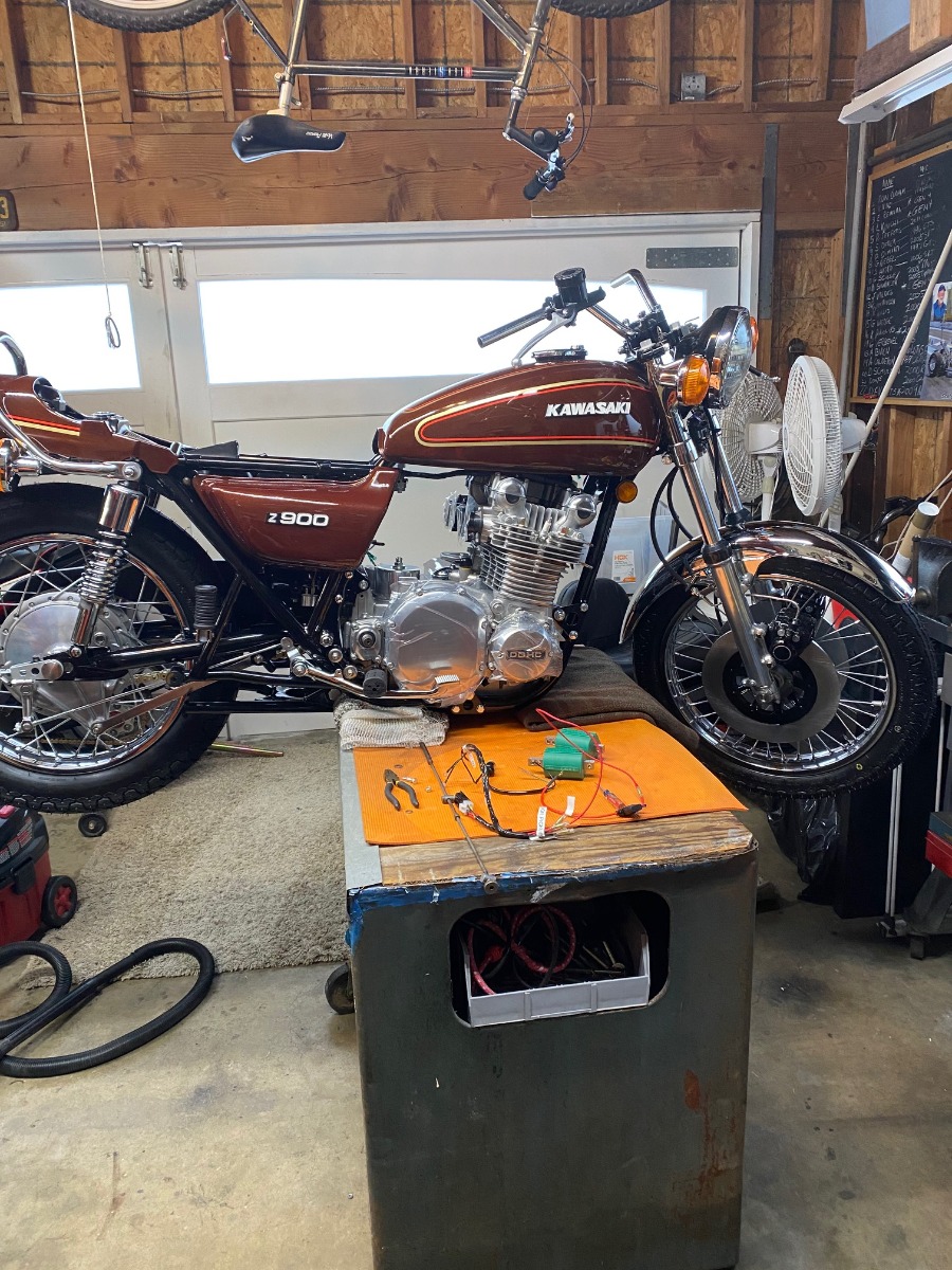

Here are a couple pictures of my progress. Its crazy how many detail there on a build you want just right. I'm sure it will need quite a bit of sorting when done.
I installed a dyna igniton and found the way the coils mount differs from the stock coils and will require a custom bracket.
Does anyone make these?
Also anyone now how to post pictures right side up. They dont transfer upright.

I'm surprised your coils won't fit the existing brackets. They should. Can you show photos?

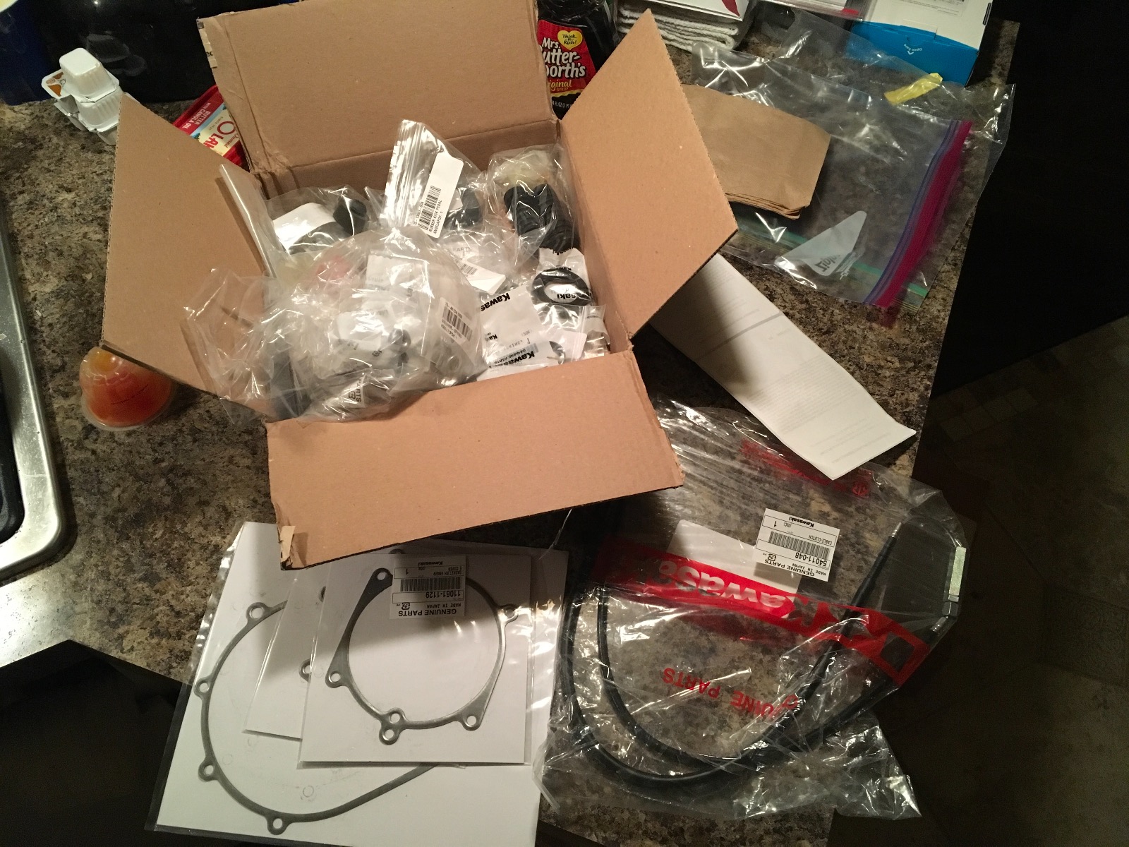

I know this oh to well. I have touched, cleaned, Vblasted, plated, re-chromed, polished, painted or powder coated every nut, bolt, washer, and bracket if it was salvageable. Bought NOS when possible, if not the best of the aftermarket. Soaked rubber in brake fluid to restore. Investigated part numbers, serial number, and dates. Laced rims, rebuilt wiring, degreased, and regreased. I have built a bike (well not completely yet) from the frame out. Call me crazy but I’m loving it. Can’t wait to see it finished and gleaming in the warm summer sun.
Good luck, I hope yours turns out exactly the way you want it.
Here’s a fresh order of NOS from Partzilla just arrived today!

I figured out the coils. I just had them orientated wrong.
