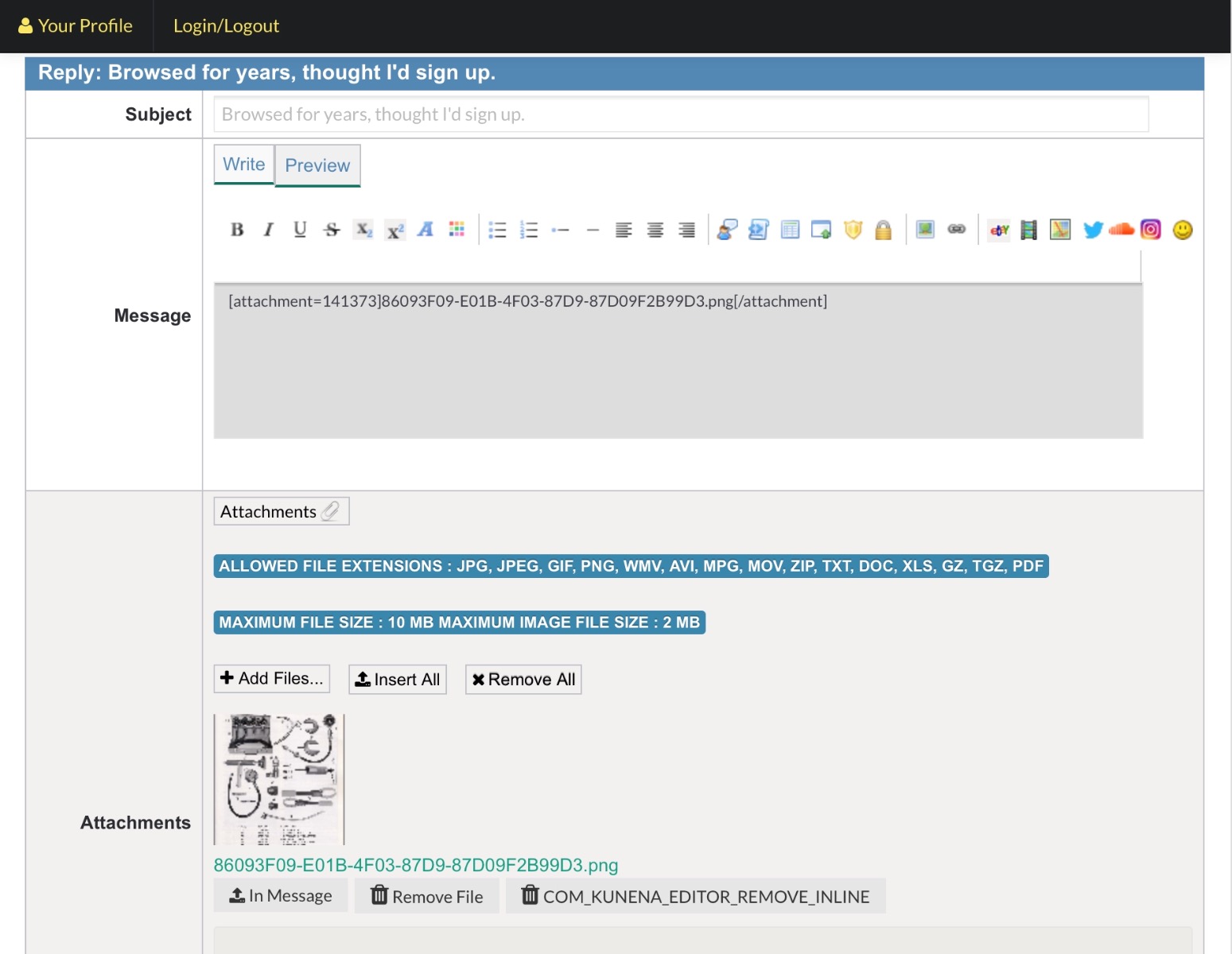

Make sure you have a complete link that looks like the one in this screen shot. If you hit backspace it will remove items and it won’t be formatted correct. You can manually add them if you delete them...
ALso don’t add emojis from your keypad. Only use the items supplied in the site provided edit.

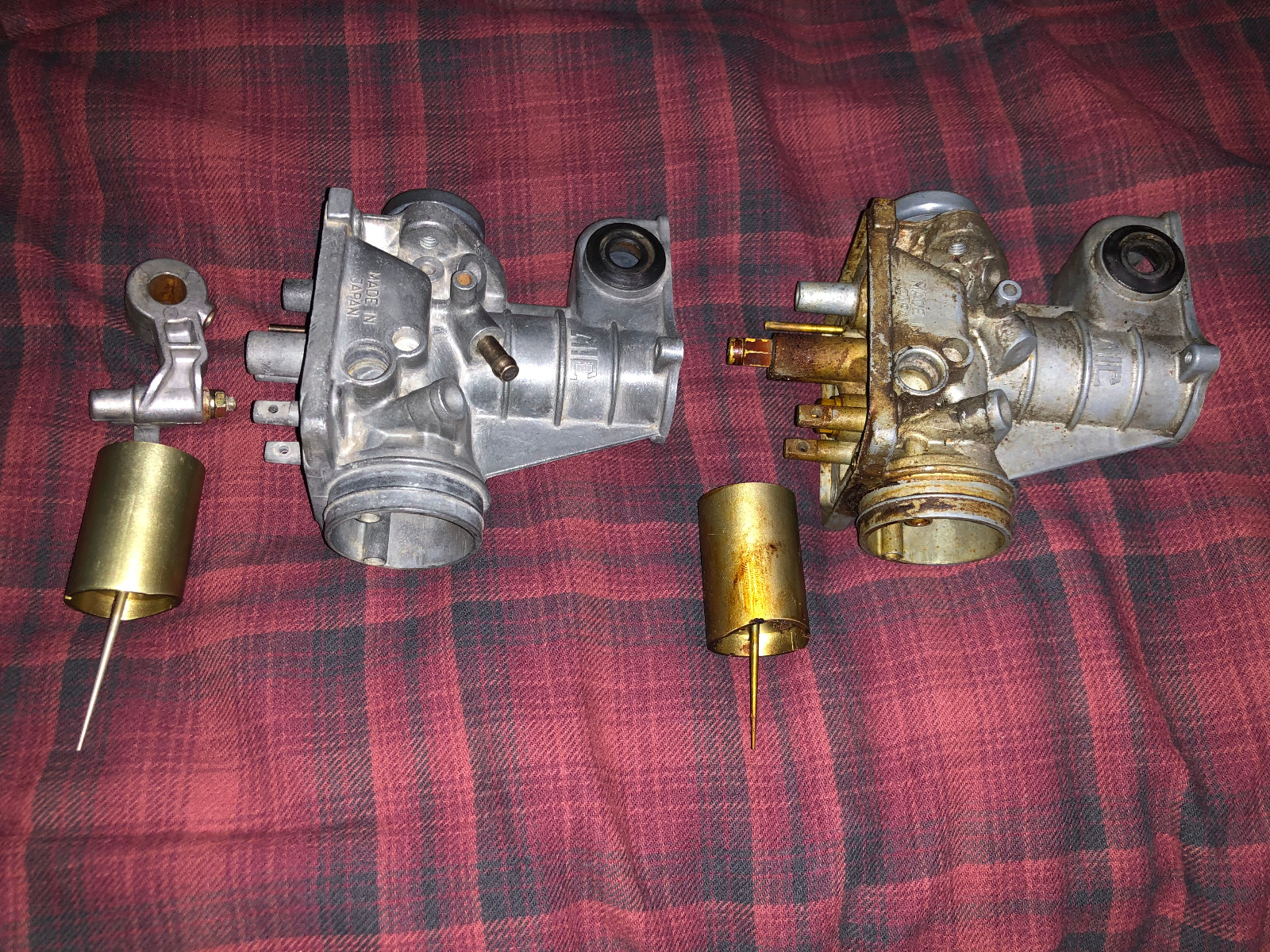

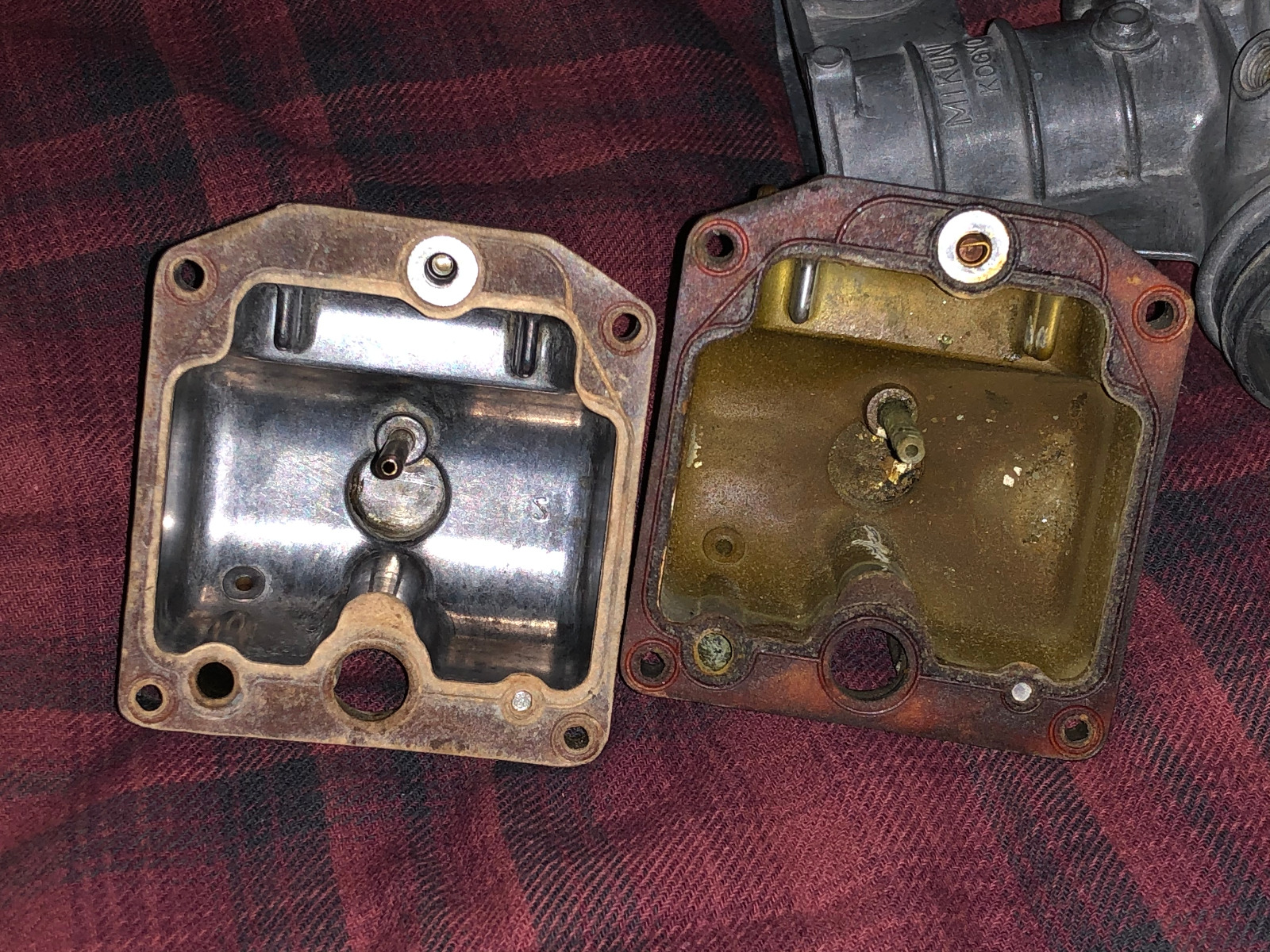

Gave one carb a cleaning to get the bulk of the grime out of it, but probably go over it again yet. I didn’t even want to attempt taking off the bowl gaskets “yet”. Working on the second one now.

I scrape of the bulk of the gaskets and then I have a large chunk of tool steel that is very flat. I place sand paper on the steel and with even pressure on the bowl I gently sand down the remaining gasket material. Checking often to make sure I'm only removing the gasket and returning the surface to flat and true

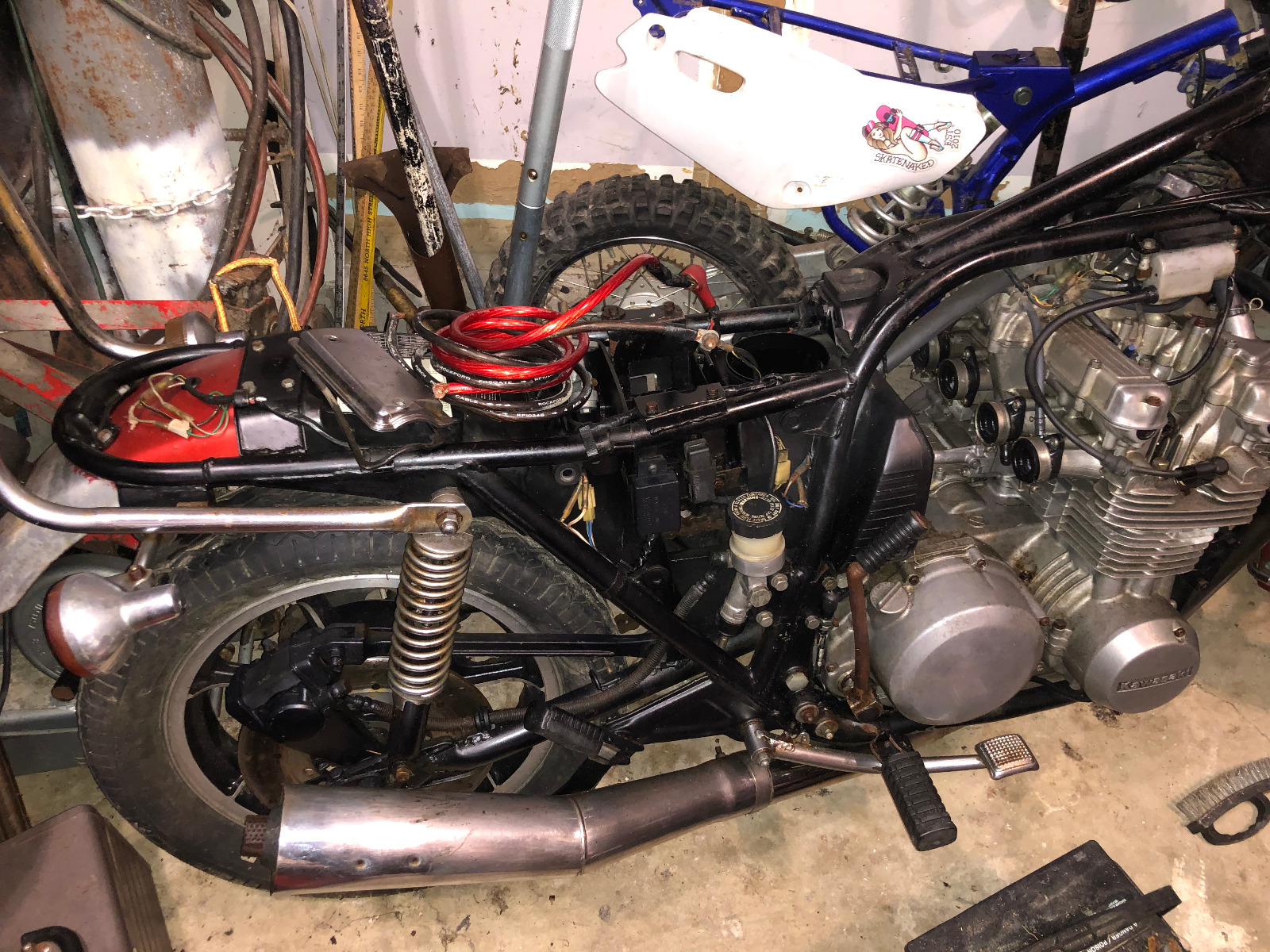

I did also do some light cleaning of the frame / engine etc., so it isn't as dirty while tinkering with it, although have not done much yet. Just didn't want more chance of stuff getting into the intake or cylinders with the carbs off / the plugs out.
