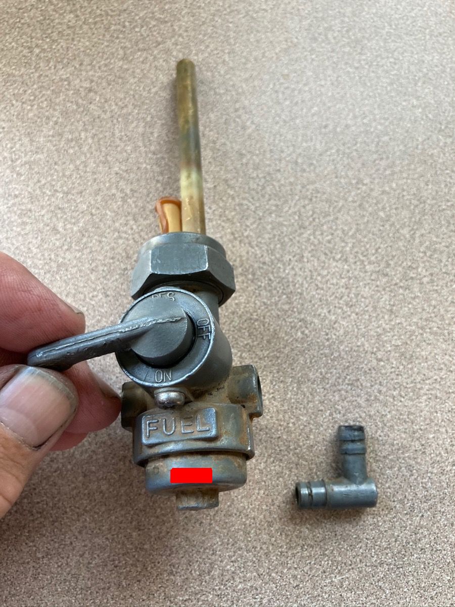

Thanks I might do that in the future. I ordered a rebuild kit and some loctite 648 if that does not work I’ll order the Pingel

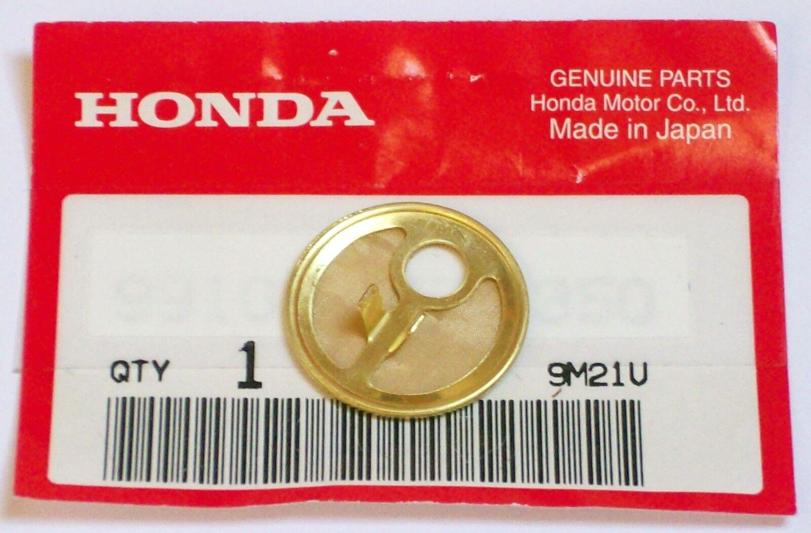

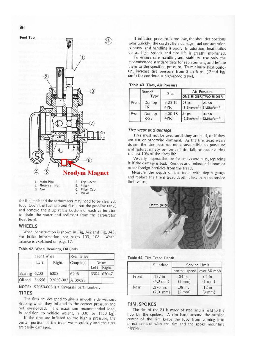

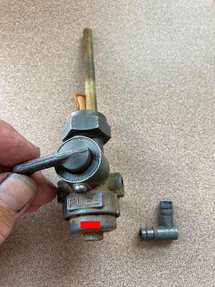

28 Sep 2020 14:51 - 28 Sep 2020 14:52#1hunter wrote:

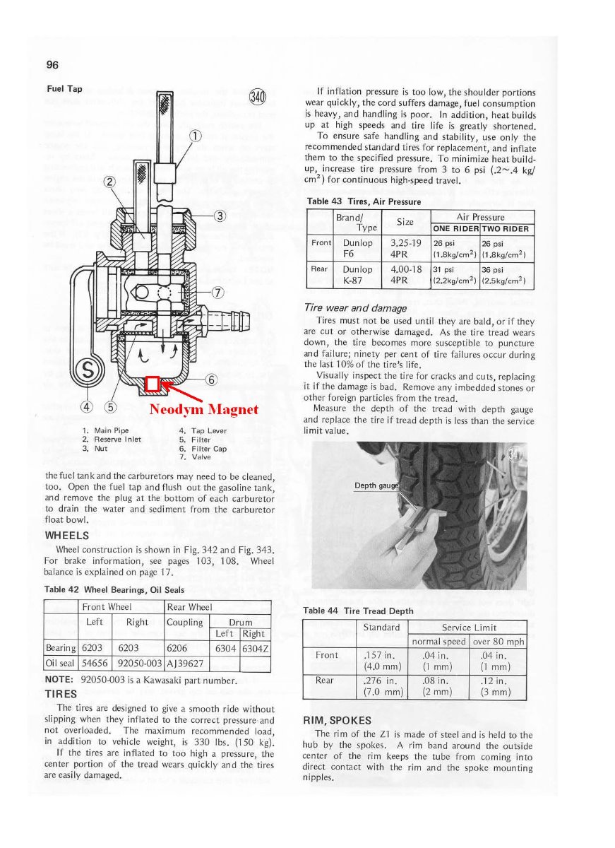

Also that little screen filter is damaged ya thing it should be replaced because all the rebuild kits don’t have the screen.
If you need a filter screen, i have a spare one. PM me and you will get the filter for the shipping costs (5 Euro).
BTW, i add a little round Neodym magnet into the petcock bowl bottom, (under the filter Screen), to catch rust particels, just a hint....

Re: New member
28 Sep 2020 15:21 - 28 Sep 2020 15:28
I am talking about the filter screen part# 5 in the Z1 Service Manual. The filter screen looks like this:
Last edit: 28 Sep 2020 15:28 by Scirocco.
The following user(s) said Thank You: #1hunter

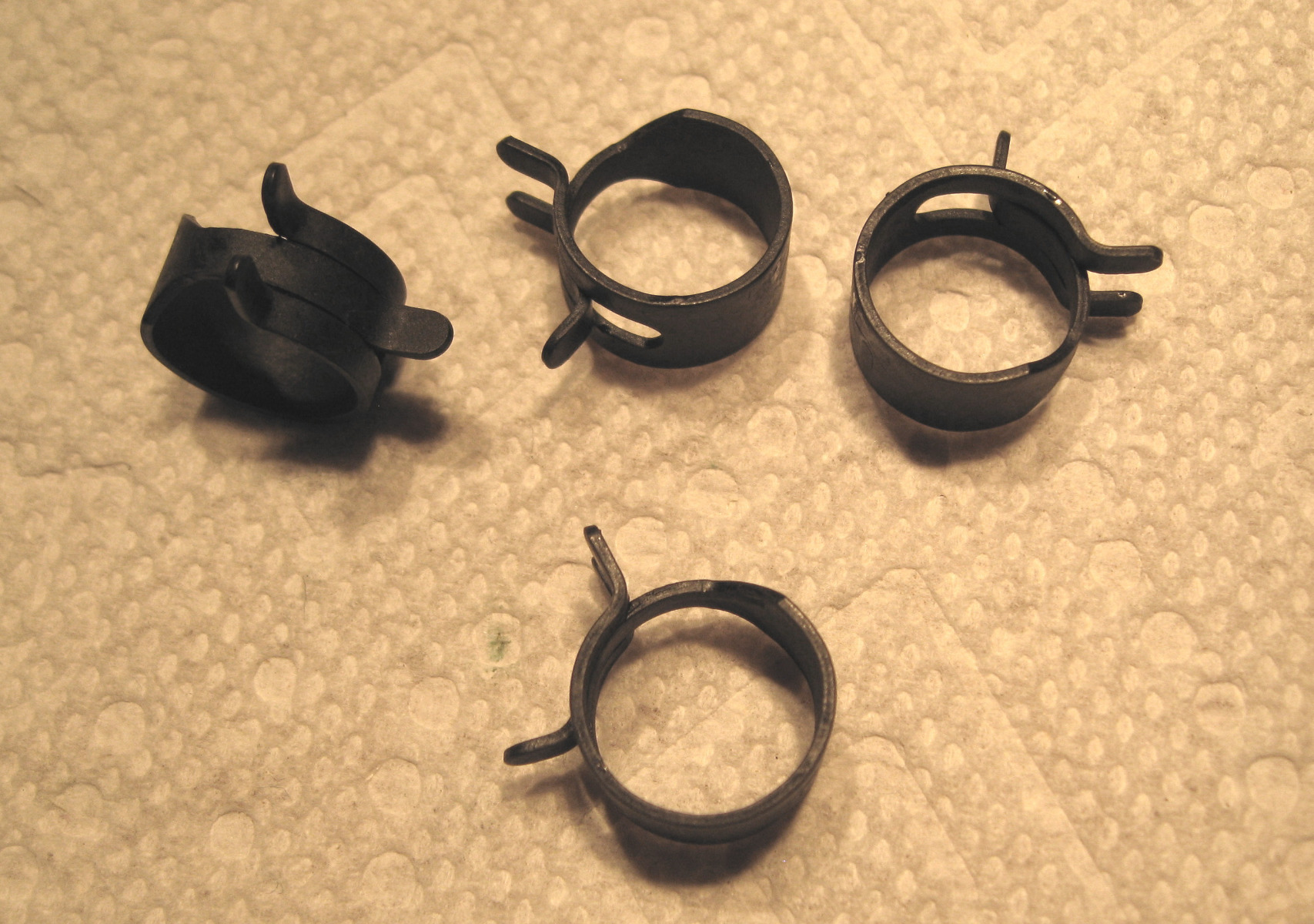

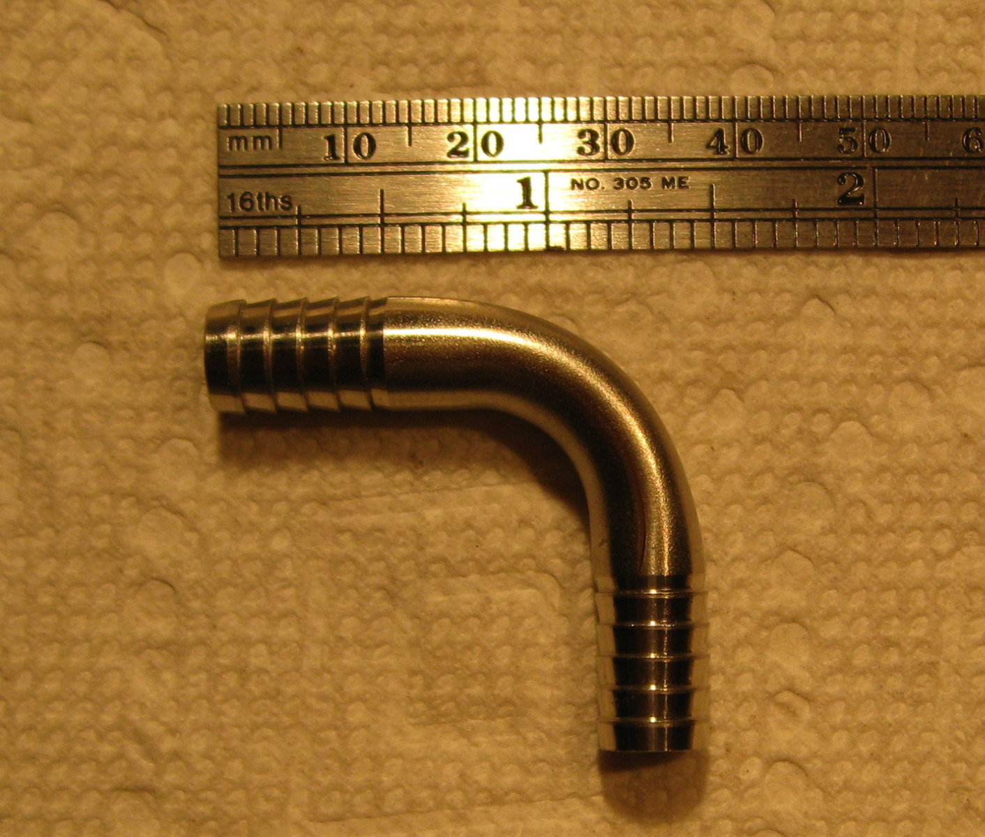

28 Sep 2020 19:57 - 28 Sep 2020 19:58Mikaw wrote:
650ed I was talking about the ?Golan? inline filter
Ah! The Golan inline fuel filter is great! It is not cheap, but the screen inside it can easily be cleaned so the filter will last forever. Oh, and nothing on it is plastic. I use the Golan Super Mini 5/16" fuel filter; see “70-312G 5/16 Barbed Fittings". It is small enough to fit under the tank with no problems. I used the squeeze type clamps to mount it. I found that the squeeze type clamps are much better that the screw type. Also, I used Goodyear 5/16" Fuel Hose SAE 30R7 (required 8") Part # 65123. Do not waste your time and money using is Gates Barricade fuel line. It has an inner sleeve that rolls up like a loose sock and clogs the line when you install it. Ed
