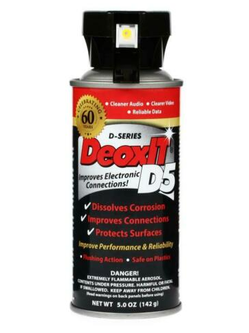

No eBay APP ID and/or Cert ID defined in Kunena configurationVery nice!
This is the best product available for cleaning up all of your electric conections.

+1 on the Deoxit D5. It is like magic in a can.
