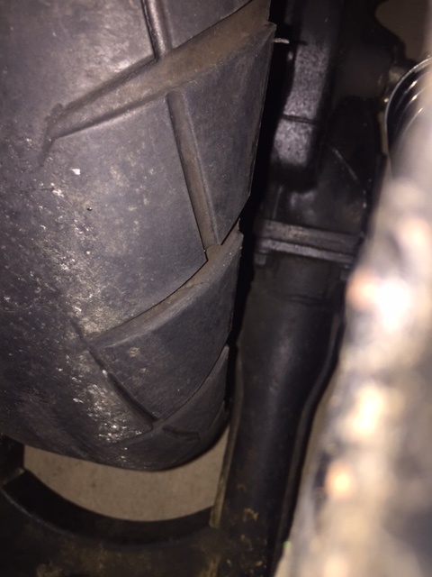

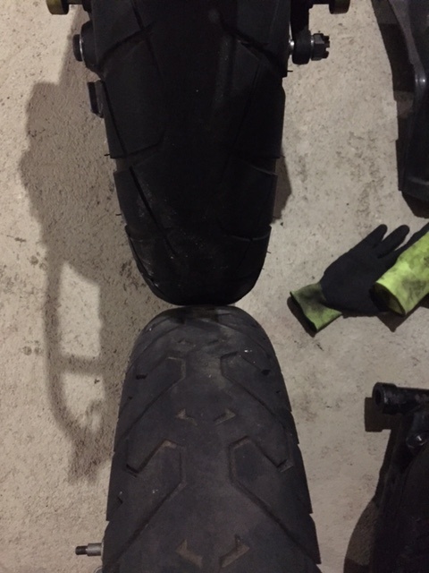

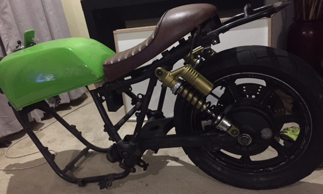

Ok so small updates. Been sourcing parts to get this underway.
The engine is with a Kawasaki engine builder. Getting a refresh with new OEM crank and rod bearings. The cruizin image pistons arrived too and they look good. Almost forged.
I've also been struggling with the direction of the wheels, tyres, possible chain conversion etc. In the end it looks like I'm going with the KZ1000 swingarm. I also have a KZ1100 swingarm but the st1000 has a cleaner look. It also uses a brake caliper that attaches to the swingarm vs a torque brace like the gt750 and the kz1100.
The 1000 swingarms are 30mm longer and I personally think it makes a nice difference to the stance of the bike. They are narrower at the pivot point which I still have to resolve, while trying to keep the wheel and drive shaft in the correct locations.
The 1000 rim is 17x2.5 vs 18x2.15 of the 750. I'm able to run a 150/70/17 tyre, but it's cutting it fine at the swingarm. The 150 tyre doesn't look any wider than the 130 to be honest. But it has a more rounded profile which should help handling. Could also be cause it's on a tiny 2.5 rim....
Anyways, here are some pics. [attachment=105659]

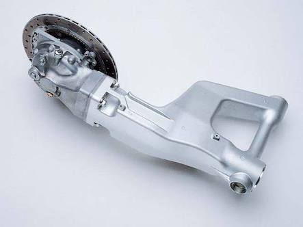

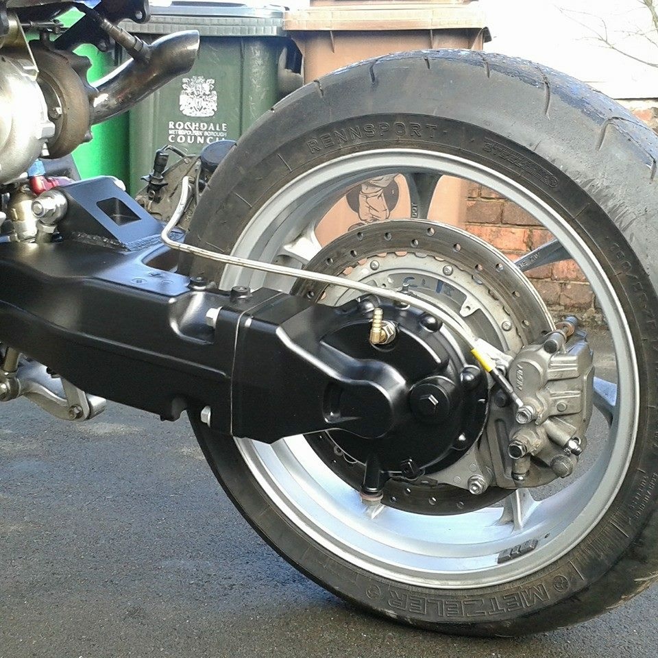

Longer term plans is to modify a GL1800 single sided swingarm and run it upsdie down to enable a 190 tyre and different wheels with a monoshock. The goldwing arm is 4.5cm wider at the pivot so it will take some substantial fabrication, and modified offset (car) wheel narrowed to 5.5 or 6" in order to get things back into alignment, But I'll look back into this at a later stage.
