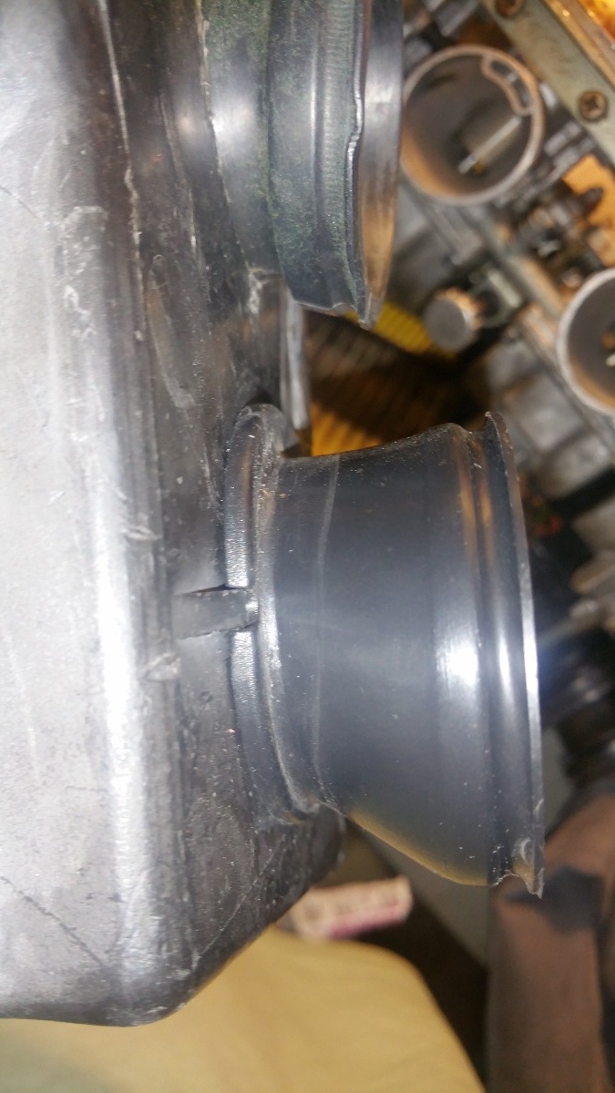

Ok bit of misunderstanding,the lip itself is what forms the seal! I get what your saying now. It should look similar to this
Guess I'm going to have to widen the hole 2 and 3 for the lip to fit around it.

Yes that's it. The notch in the lip and the tab.
Were the outer two holes bigger for some reason? That seems odd.

The outer two holes were indeed larger. The two inner ones have no notch
