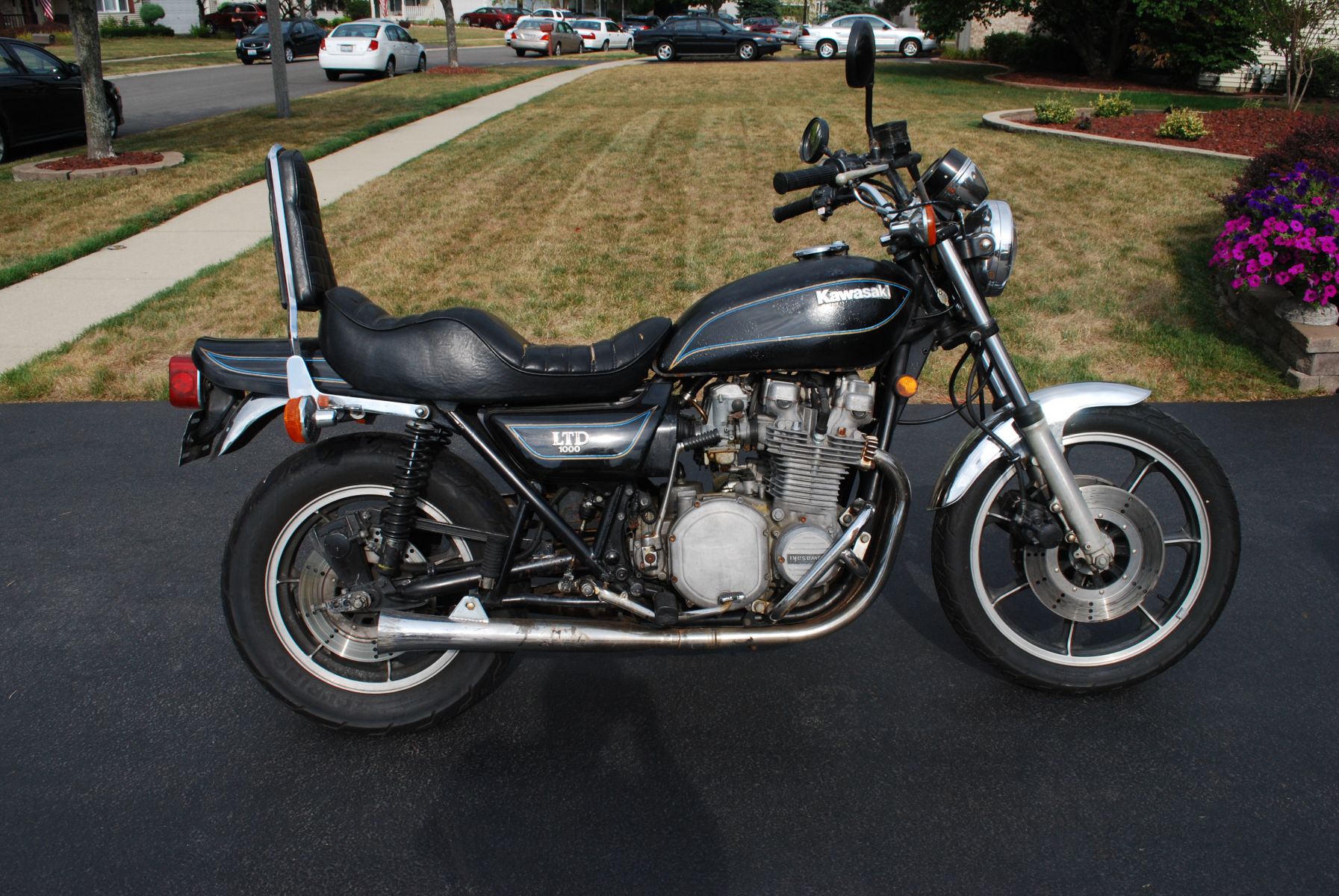

19 Aug 2012 22:14 - 19 Aug 2012 22:16nospeed2 wrote: ...79 LTD...My plan is to run pods....
Hello, nospeed2, and WELCOME to KZrider!
Would suggest obtaining new air box hoses and keeping the air box instead of changing to pods.
With new hoses, the carbs are easy to remove and replace.
And the air box has many advantages over pods.
Would also consider keeping the existing jets, at least until the carbs have been properly cleaned, and the bike otherwise fully tuned and test-ridden.

Dude, that doesn't look overly weathered at all! Remember these bikes are older than most folks that post on here. They were built to run like a cat with its asshole on fire so most of them were ragged out long before the Fox network was even a concept.
Congrats on the find and welcome to the madness!
Ditto on the pods. They look cool and all but they are a hot mess to deal with unless you got the patience of Job.

20 Aug 2012 09:34 - 21 Aug 2012 02:24nospeed2 wrote: ...It seems that putting the airbox on is going to be a nightmare....
In the pic, it looks like the air box is still on.
It isn't necessary to remove the air box when replacing the air box hoses (a relatively simple. quick and easy procedure).
And BTW, don't toss that sissy-bar, as it's one of the best versions available.
If unwanted, it will bring a good price.

Patton wrote: In the pic, it looks like the air box is still on.
Agreed - the picture shows the airbox on the bike, and you do not need to remove it to work on the carbs. If you replace the airbox-to-carb ducts you will find it easier to remove and replace the carbs, New ducts are soft and much easier to work with. Ed

nice find as complete as she seems keep her that way there are enough truly ratty bikes out there to
mod if thats your purpose.
Keep the pic's coming we love wathcing these girls come back to life

You have a nice starting point. That bike doesn't look hurt at all. Just needs some steel wool, mag polish and a bucket of elbo grease to be a real stunner. I had one exactly like it. Trash the sissy bar though. Keep us curent on your progress. We all are picture junkies. (Mike)
