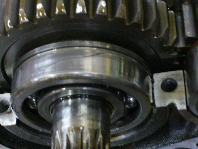

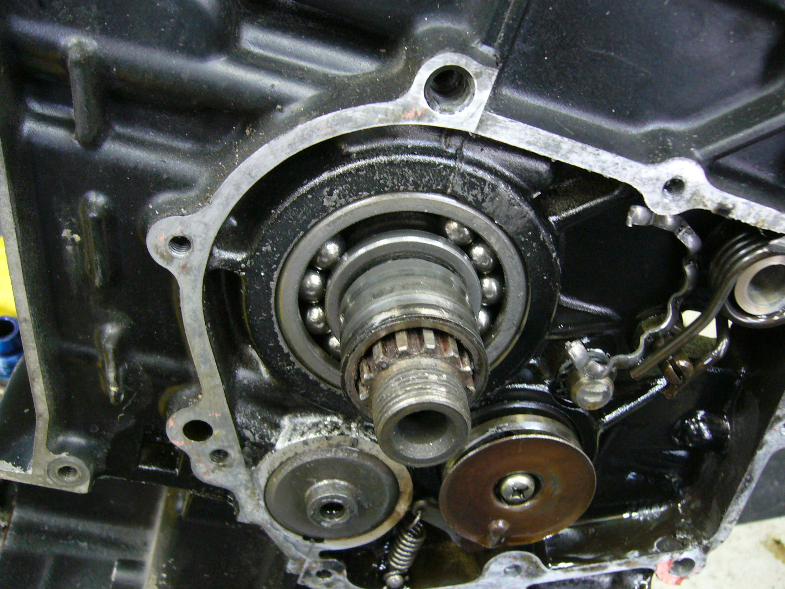

i don't know about shaft drives,but i have seen the output shaft bearing break around the circumference and pop the cage off the bearing.then the balls clickity clack on each other ass they roll over the top of the race and fall down the other side.

Uh oh. That looks like what the sound sounds like. At first I was thinking the sound was something to do with the neutral finder because it does sound like little ball bearings falling into place.
We'll have to see if we can yank the right-angle drive.
