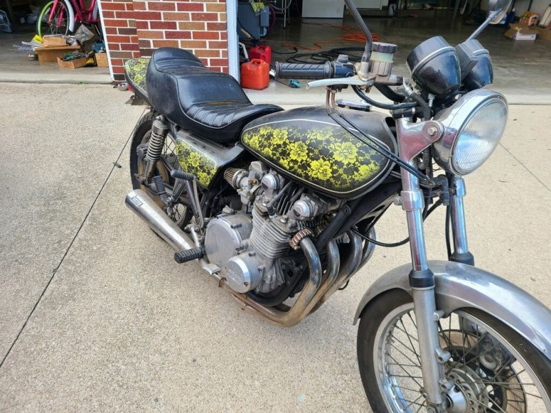

Here's a picture of me and Christine (back when she was rideable).  And here is Christine's replacement, which I've tentatively named Paris, mainly because she's amazingly fast and makes most other dudes jealous ;)
