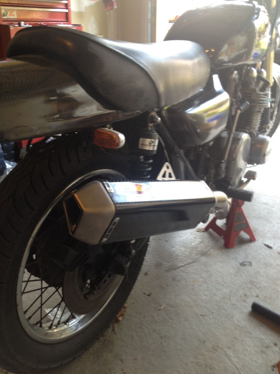

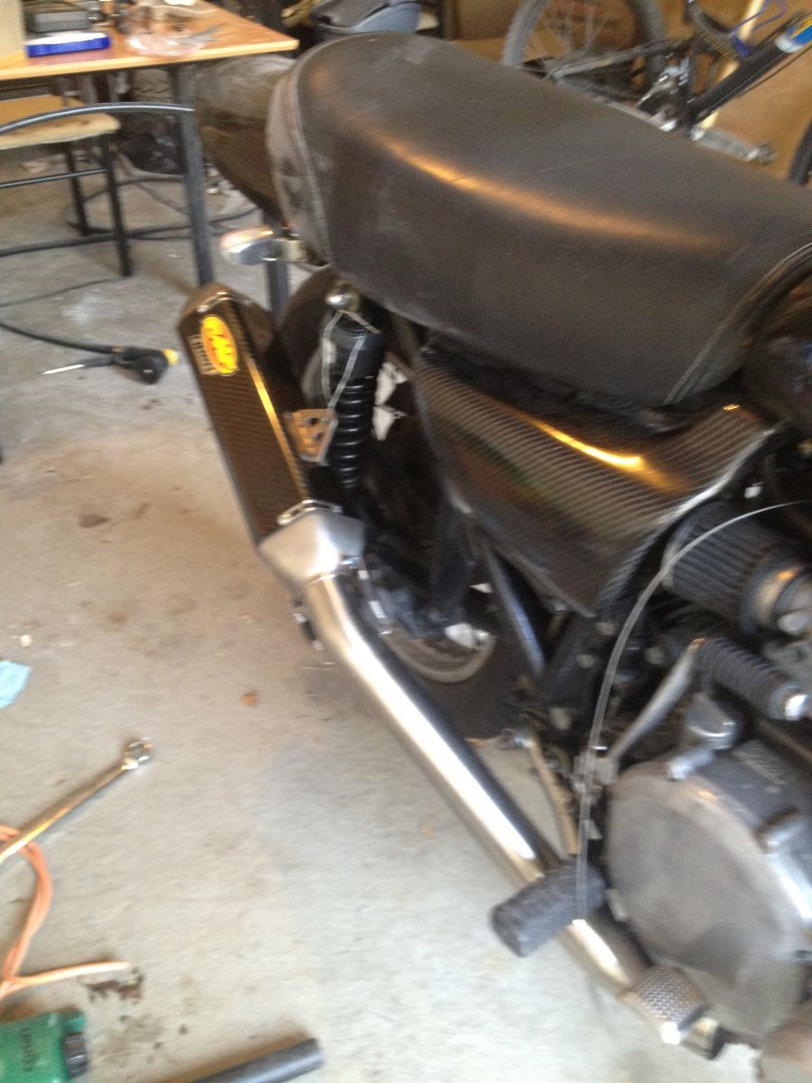

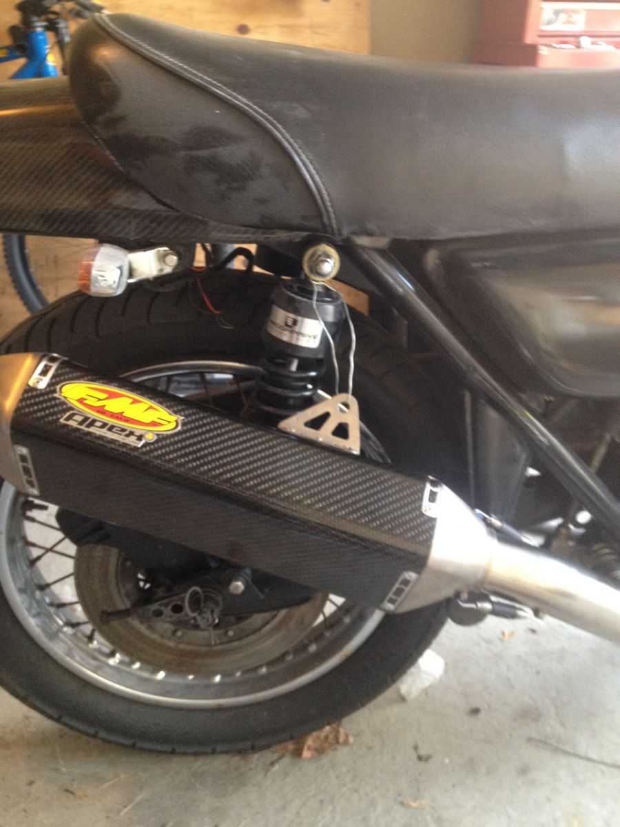

I went to one of my local shops today to pick up a scrub tire and came across a deal that I couldn't pass up on. He had a FMF carbon fiber slipon hanging on his wall for a GSXR1000. Brand new in box for $300 CDN!!!! yup gotta have it, see pics
as you can see I am just mocking up the bike so it isn't attached permanently. Just hung with some wire.
Anyone have any ideas for some custom headers???
