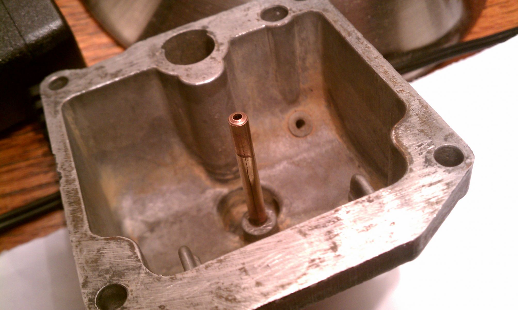

I have a 1981 KZ440. I thought my float level was off because fuel was leaking out the overflow tube. I opened up the carbs and one of the overflow pipes is cracked right down the middle. The other has a small hole. Is there any way to fix this? Is it even possible to find new bowls? I read online about someone soldering the crack, will that really work safely? Thanks.

Some people put a piece snug fitting tubing over it. Seems the easiest way. Myself, I took suggestion from here and soldered it. Seems more permanent IMHO.
Before
After

What are the steps for soldering it? Thanks so much that's exactly what mine looks like.

I got thin brass tubing at a hobby store. Cut the right length, slipped it over the existing tube and soldered all around the bottom using electrical cored solder, the type that has the flux built in. That was 7 or 8 years ago.
I used a soldering iron usually used for electrical. Worked fine. I have never used a torch but would suggest being carefull not to melt the bowl which is made of cheap pot metal.

So I torched it and soldered it, took a while to get it right, then when I went to sand down some excess solder the tube was so flimsy it broke off. Called a local shop and he said they have tons of used ones, I'll pick them up tomorrow. When I bought this bike one of these overflow ports was plugged and one was vented but the hose was stuck up real high, now I know why. I'm wondering if that could have been part of my idle issues. If your float level is in check do these things need to vent, could you run with them just plugged? I promise I'll stop asking questions after this.

You don't want to run them plugged up. If you do, and your float needle gets stuck open, then the only place the fuel has to go is into your cylinders and then crankcase from there on. You will then have contaminated oil which will need to be replaced. You should always have these overflows working properly and shut off the petcock when the bike is parked as well.
