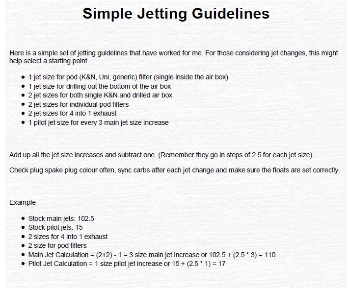

Here's a good rule of thumb... Pretty much says it all...
In "carbs rebuilt by XXXXXX (not gonna say who)" defense, the carbs could indeed be jacked up :pinch: no doubt and very possible but............
They also also could be just fine where you sent in your carbs that had previously been jetted for air box, elevation you live in, environmental temp conditions, different exhaust/baffle whatever...
Now if you're throwing on pods, possibly different exhaust, head port work, change in cams etc... who knows all of which require a jetting/tuning/tweak/needle clip change etc...
