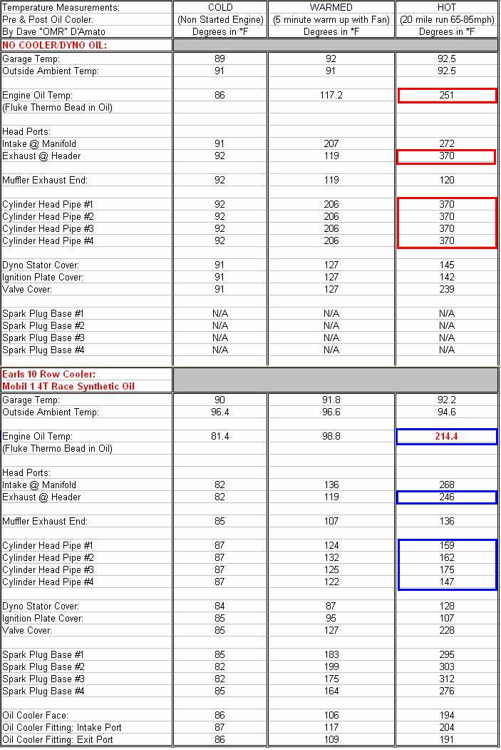

Other then 30-40 degree oil temp drop to ideal operating temps... My biggest surprise was most likely due to the air deflection over exhaust ports resulted in huge cooling effect...
Of course, stop and go traffic, cooler doesn't do a damn thing... Yeah we get it.... :whistle:

OMR, not sure what you mean:
The addition of an oil cooler deflects air down to the exhaust ports on the head?
Old Man Rock wrote: My biggest surprise was most likely due to the air deflection over exhaust ports resulted in huge cooling effect
