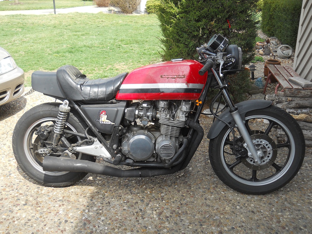

Welcome ColoPirate, I like the direction you are going with your LTD.
Similar to this

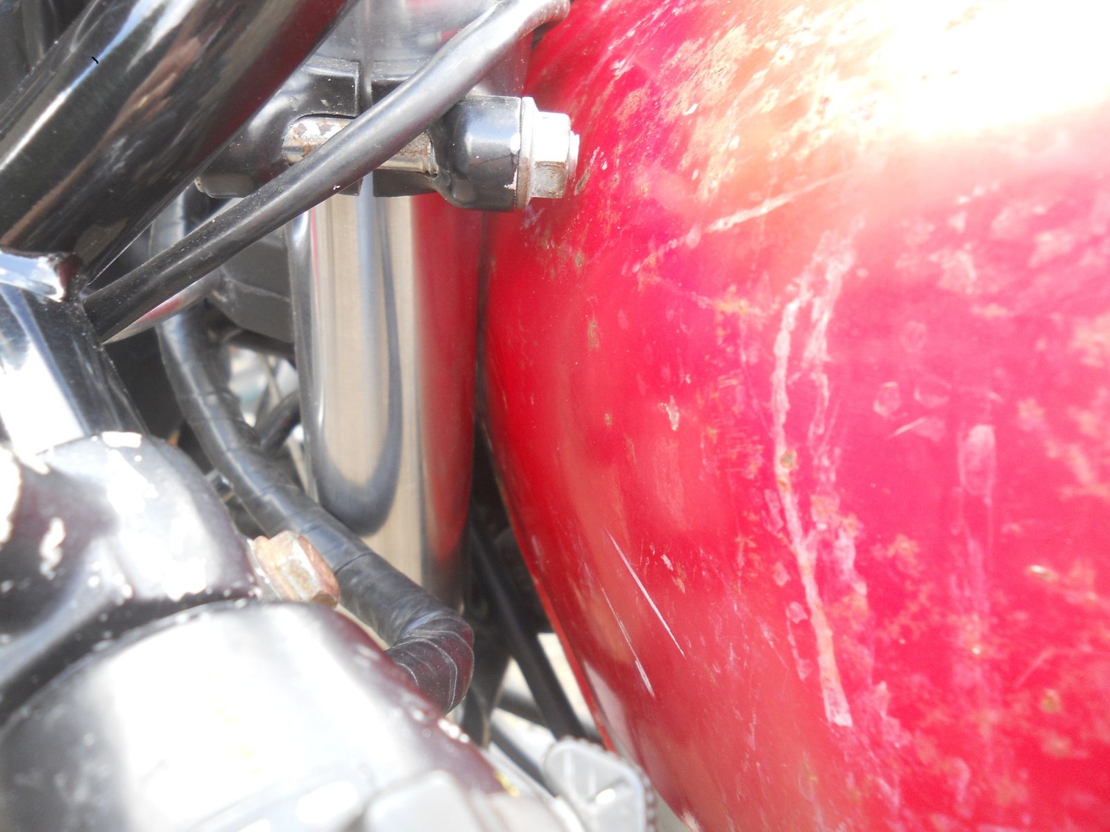

If you have not already checked the stearing lock to lock, this is what you are going to find
Remedy is to block the stops, dent tank for clearance or change tripple tree to non LTD standard with more fork offset. I will be changing the tree.

Rainman - very similar! I think with the drag bars my controls are hitting the tank before my triple tree, but when i switch to clip-ons (when i feel like spending another $150) i will have to look for that. what did you use to block it? im having trouble figuring out the picture.

Hey Rainman, did you make that cowl or get it from a different bike? Also, is your frame an LTD or standard?

ColoPirate, No blocking yet, I will be swapping the tree for one from a standard (78 KZ650C2) with more forward fork offset.
apbling, the tail is a chopped up tailpiece from a 79 KZ750B4 twin. Yes it started life as a LTD (80 KZ750H1), with slight frame tail chop.
