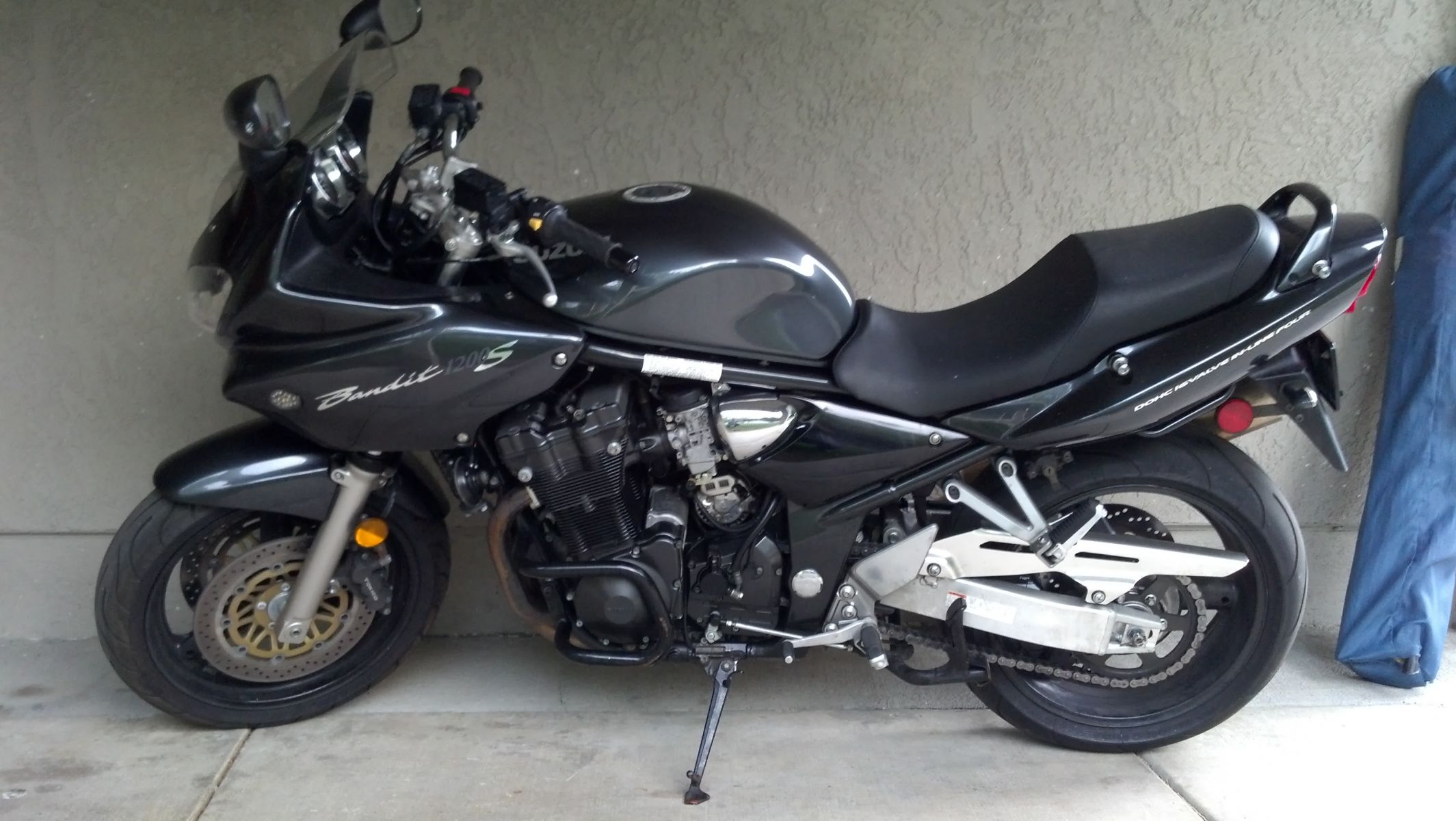

porchev914 wrote: I brought a new toy home the other day as well. I was offered a job with the department of defense, and accepting the offer means commuting about 70 miles a day. Soooooo, I got a commuter bike! An '04 Suzuki Bandit 1200 with 8300 miles.
If I didn't want a ZRX so bad then I probably would already own a B12. Nice bike! If you don't mind, send me a pm with what you paid. I like to keep track of these things. I bet you have been riding the wheels off that thing. As long as your KZ has been down, I bet you were jonesing to get the wind in your face.
Let's celebrate! Mulholland next weekend?
